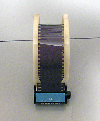

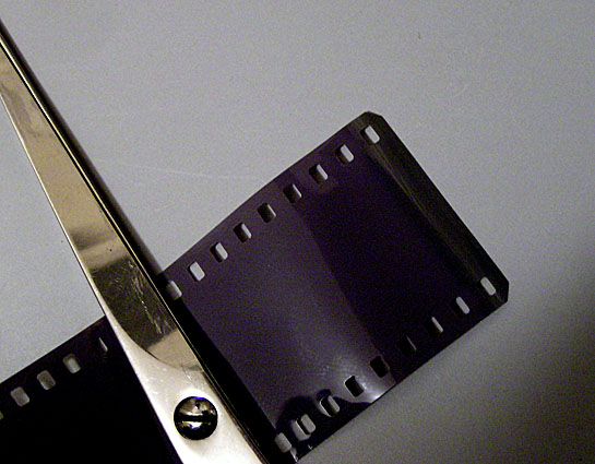

Here's my reel loading method which works 100% of the time now for me. I prefer Jobo reels to Paterson as the rings are wider and less prone to sticking but this method also works for dry Paterson reels in good condition.
1. Always in the dark (never use bag anymore)
2. Cut off leader and round corners of leading edge of roll (see photo)
3. With lights on insert enough film so it is firmly engaged in the reel (see photo)
4. Turn off lights
5. Stick reel between lips so film canister opening and reel take up are in the same plane reducing tension on the film to a minimum. Gently pull the reel away from the lips about one foot(30cm) at a time and rotate the reel taking up the film. Always keep just enough tension between between canister and reel so the film does not kink or bend. (See photo)
6. When film is fully loaded remove canister from lips, take scissors and cut of leader
Proceed in good temper from there having avoided profanities and taking the lord's name in vain!!
