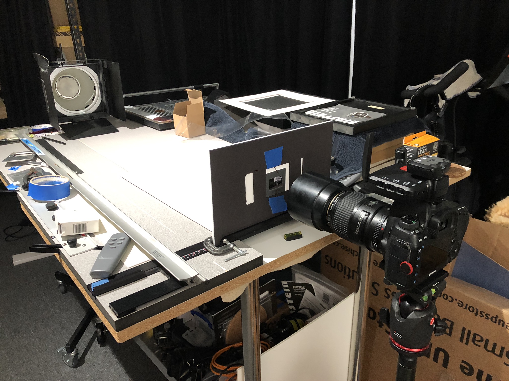

I use a DSLR for scanning and my set up needs to be changed as the room for error is great. I have determined this slide didn't get focused properly. In addition to improving my set up I'm going to start to use the live shooting feature of C1 pro, which I'm currently using for tethered capture. It has a great focusing feature. I quit using it for film scans as it takes longer and I thought I had my method dialed in.

On closer look I can't see any grain either! When I discovered this frame had scan focus issues I did a quick test using my iPhone as a light source. I laid the now mounted slide on my DIY diffused film holder , then on the phone and took a shot. Then I removed the diffused film holder and took a shot without. I can see the grain in both shots, and the shot without the diffuser had slightly sharper grain. The difference is most likely similar the grain sharpness of a condenser enlarger vs a diffuser. My current method shown below needs to be changed for easier more consistent results. If I went to a vertical set up it would be easier to advance the frames, and less likely to have this type of problem. For kicks I threw a neg in my Durst enlarger and laid my camera on the easel. I took off the enlarger lens and turned on the enlargers white light. The result was impressive but not quite as good as my current method. I think if I laser aligned my camera to the negative stage, it would be very good, and the vertical setup would allow me to achieve the flattest film with the least amount of hassle.
