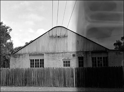

he's my one example of doing this. Was a Paterson System 4 tank
