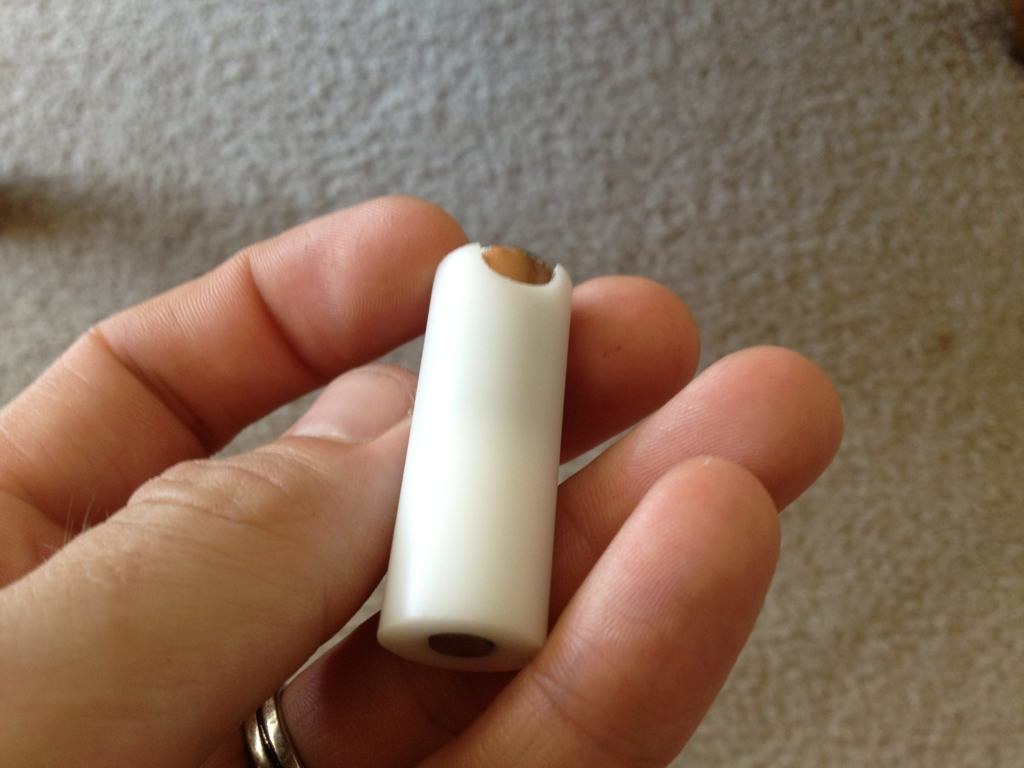

Yesterday I received my first rangefinder. My stepfather handed me a Yashica Electro 35G, along with a Polaroid Land Camera 95. The Polaroid will become a piece for the collector case and will be putting the Electro in action. I picked up a replacement 23A and will see if I can machine a adapter housing. After reading reports of people using them and seeing the image quality, I'm very excited to see what I can do with it.
Any tips for the new owner?

I do not think that you will find a better lens but, pray tell, where did you find that oddball battery? Must you retrofit instead of using the original? That said, it's a shame you do not have manual override or the ability to choose aperture. (Am I incorrect?) - David Lyga

David, I machined an adapter out of derlin plastic stock and put in a metal rod for conductivity. Its very sturdy and will last the lifetime of the body and longer.

You can get a proper adapter at Yashica Guy's website, or on eBay. The adapters that allow you to use a 4LR44 or 4SR44 are the best type. Also, make sure the light seals are in decent shape. You can use black yarn and glue it into the seal channels, and use the black felt material from old 35mm film canisters to make the big seal near the door hinge. The Yashica Electro 35 can take superb photos.

San, I checked out the adapter, but I didnt want to pay for something that I can make during lunch at work. The adapter is made to be a direct replacement dimensionally using a 4LR44 "23A" battery. I will post a picture of it a little bit this afternoon.
