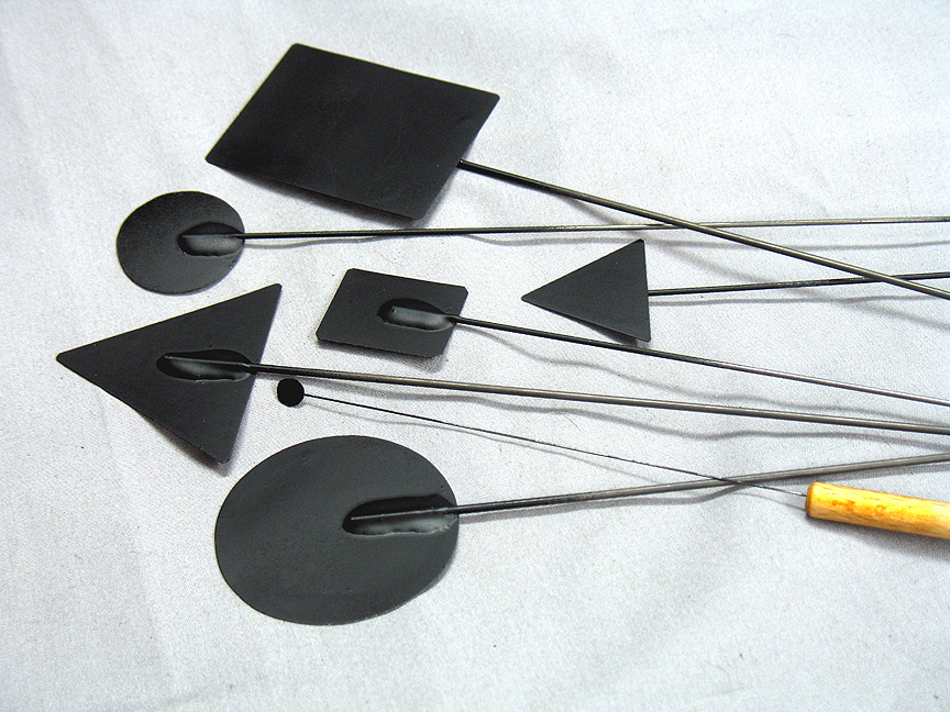

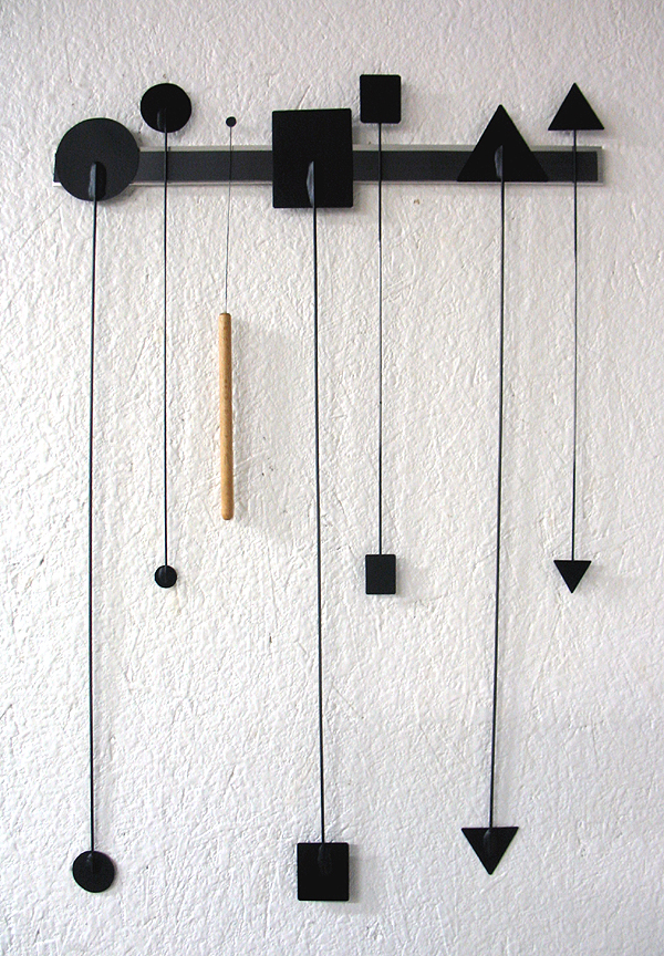

Second question: In darkrooms you have used, what do you find yourself most thankful to have around the workspace?
Aside from the the enlarger timer and a focusing magnifier, the most used items are my dodging wands.
They're up on the wall, not on the counter top or under some nearby clutter.
They're used almost 100% of the time.
Indispensable.
