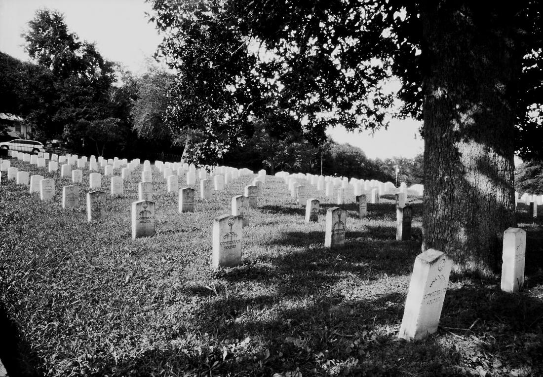

I just posted my first shot with some free sample X-ray film I got. High Speed Blue Sensitive. I actually overexposed it a bit, or overdeveloped it, as it is dense. There is also a "glow" around the highlights a bit, and of course the sky is washed out, due to the blue sensitivity. Kinda like the effect though. I will be posting more soon. I have uploaded the photo again to this post for convenience, but if you want to view all the details involved you should view the photo in my gallery here.

Phototone, that looks really good! Is this the CXS stuff?
What EI did you expose at, and how did you develop?
Yes, it is the CXS stuff. I exposed based on an ISO of about 12, but I found this was a bit too low, now I am trying about ISO 30 to 50. I developed under a red safelight in HC-110b by inspection...developing time about 2.5 to 3 minutes on a hanger in a deep tank, lots of agitation. The film has a blue base tint, as most X-ray film does. Other than processing by inspection, the film was processed just as if it were regular film, with a 30 sec. stop bath and then 4 minutes in the rapid-fixer, then a 20 minute wash.

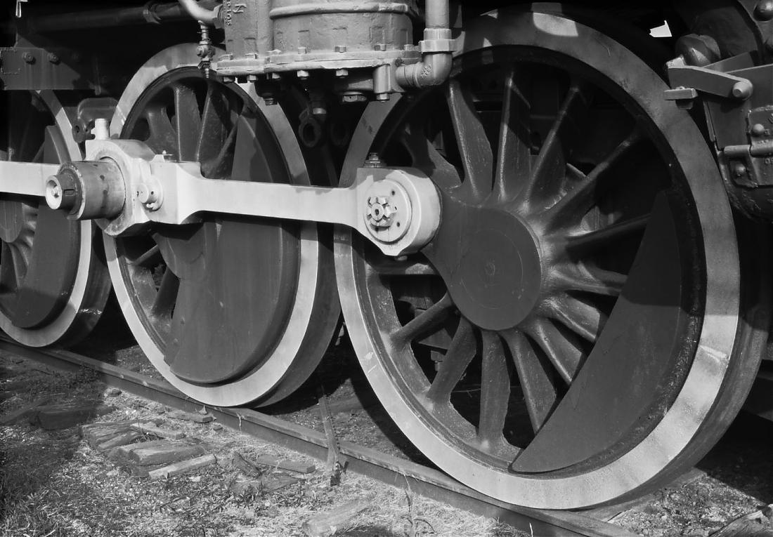

Here is another example of a shot on X-ray film, from my recent free sample. I have ordered a box of 100 sheets so I will be shooting it more frequently.
