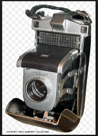

First camera with a couple electric eye for automatic exposure was the Kodak Super 620, 1938-1945.
Slick camera, very rare. Coupled rangefinder. The selenium cell adjusted lens opening, and changing the shutter speed adjusted the meter cell, so it was full auto-exposure.

Wow! Full auto in 1938!
Unfortunately very unreliable from what I've read though (and cost something like $3500 in todays dollars). It is very impressive though.
In fact I think today it also costs about $3500 in today's dollars if working properly due to it's huge collectible value.

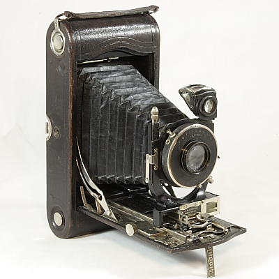

I believe range finding first showed up in the Kodak 3A Autographic special from 1916(!)
I kind of want this camera since I always seem to forget to focus half the time I use an old folder.
Auto Exposure in the 1938 Super Six-20 (and then reliably in the mid 1950s)
Integrated AF (and film advance) in the Minolta Maxxum 7000 1985
