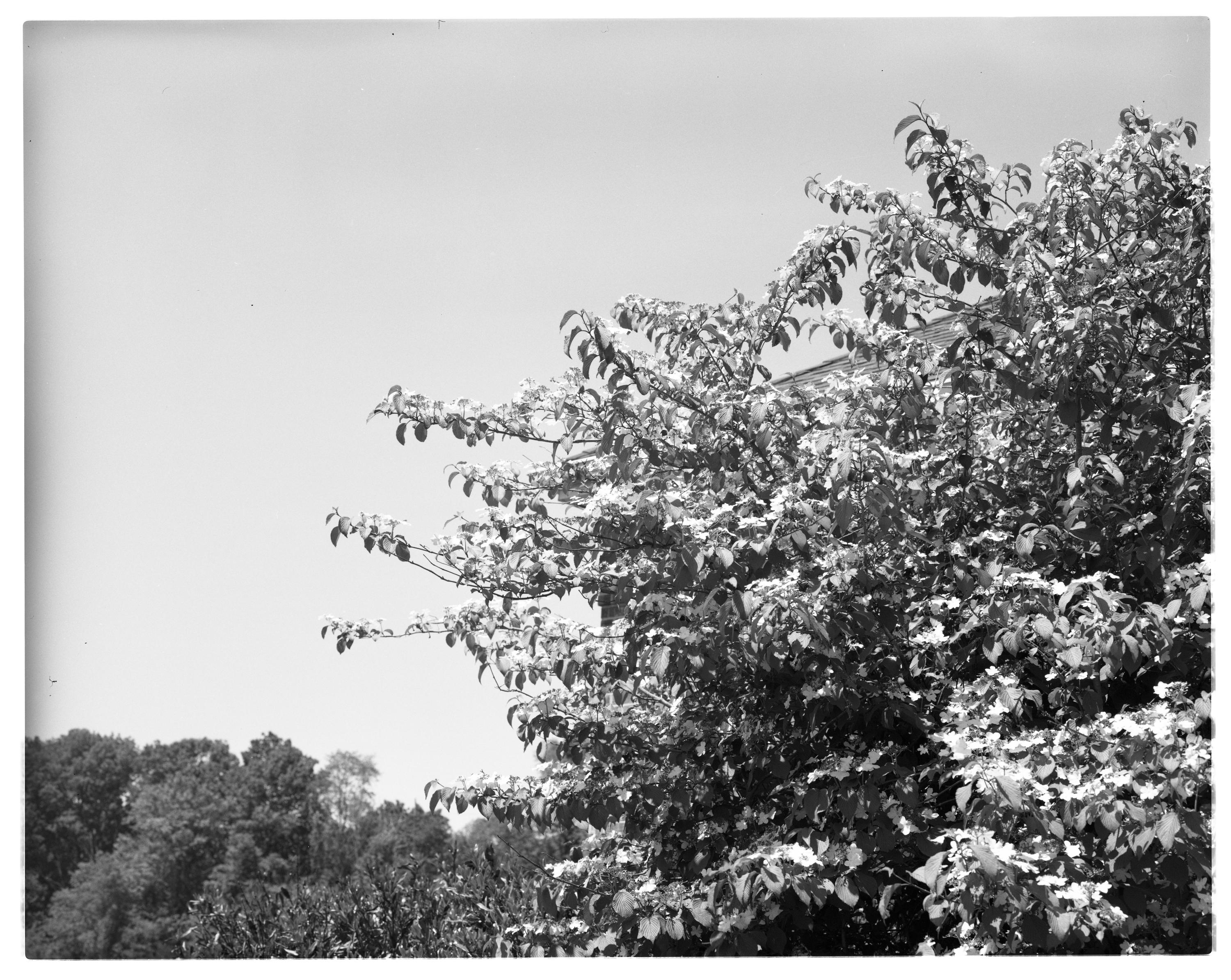

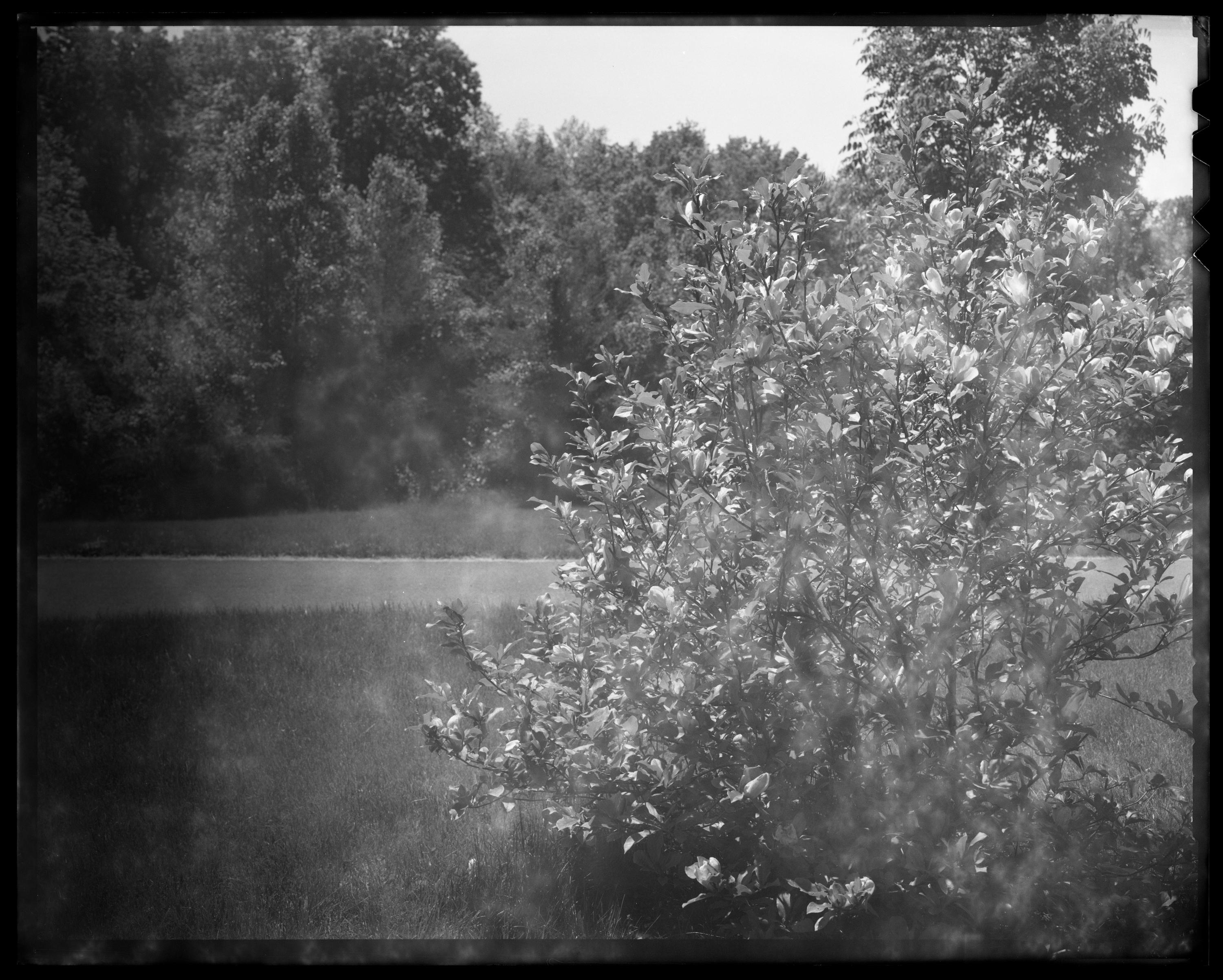

I just made two test shots with my old (expired 1983) Tri-X Ortho 4163 4x5 film.
See (there was a url link here which no longer exists)
Here they are:
The set up is Sinar F2, Sirona-N 150mm/F5.6, F22, exposure 1/60 and 1/30. Developed with regular D-76 at 5.5 min @70C, in Jobo 2509 reel within CPE2.
The first photo was metered with ASA 200. I forgot to reset my Gossen meter. The 2nd photo was metered with ASA 50.
The 2nd photo looks fine. But something is wrong with the first photo. Is this film fogged? Again, this is more than 30-year old film. The film stays inside a soft pouch inside a triple layer box.
Other than fogged film, could this be any developing problem? I loaded each film on each side. As far I can tell, I loaded the film in the film loader correctly and I loaded the film inside the reel correctly.

You are correct that the film was rated at 320 daylight. I had some concerns before since I heard this film has extreme contrast. Some recommended to use diluted developer, even Dektol developer. But the regular D-76 is just fine. This is also my first time to use D-76. I normally use regular T-max, but it is not good with sheet film.
The first photo does not show the regular fogging. The sky is still bright. The defects look more like lens flare or developing problem. Just wonder what would happen if the film was loaded with emulsion side facing outside (should facing inside).

the mottling has a rather structured look not unlike the leaves on the bush -- you sure you didn't double expose it somehow?
Other than that, I'd say try new film and start anew. Sometimes shit happeneth...

I would be interested to know if you can see the pattern on the negative using oblique light. It looks like a mildew pattern to me - and that might come from the packing card. If you can see the pattern on the film or emulsion surface then that is a line of investigation. Acidity on the emulsion would inhibit development.
I don't think it is developing marks - bubbles would not stay on a Jobo unless you left traces of wetting agent in the tank, and then it would affect all sheets. Equally it does not seem sharp enough for physical damage.
There is a slim chance that it is a pinhole light leak, maybe while loading the tank. If this was the outside sheet and loaded emulsion out, it is vulnerable. Changing bags are a bit of a problem with this since you can't see what the film sees. A strong flashlight inside might show something, especially near the opening.

Yeah, the mottle looks like surface oxidation of the emulsion. It probably reacted with whatever it was next to in the film box. Like the cardboard on the outside of the stack. Or, just being at the outside, it was easier for air to get at it.
I shot a couple of Wratten and Wainright glass plates, and the outer inch and a half of the plate was fogged, there was just a small rectangle of functional emulsion in the middle. The air hadn't gotten to the middle, but had to the edges. (They are packed in pairs, emulsion to emulsion.)
I think "mildew" is the word. Someone earlier mentioned "damp" with the film. The film was stored in basement and maybe in someone's garage too. Moisture can easily sneak into the opened bag.
I used a Harrison change tent. I do not there is any light leak with it. The Sirona-N is a high-quality lens and I do not think there is any ghost, etc. It was a simple scene with the sun at my left side.

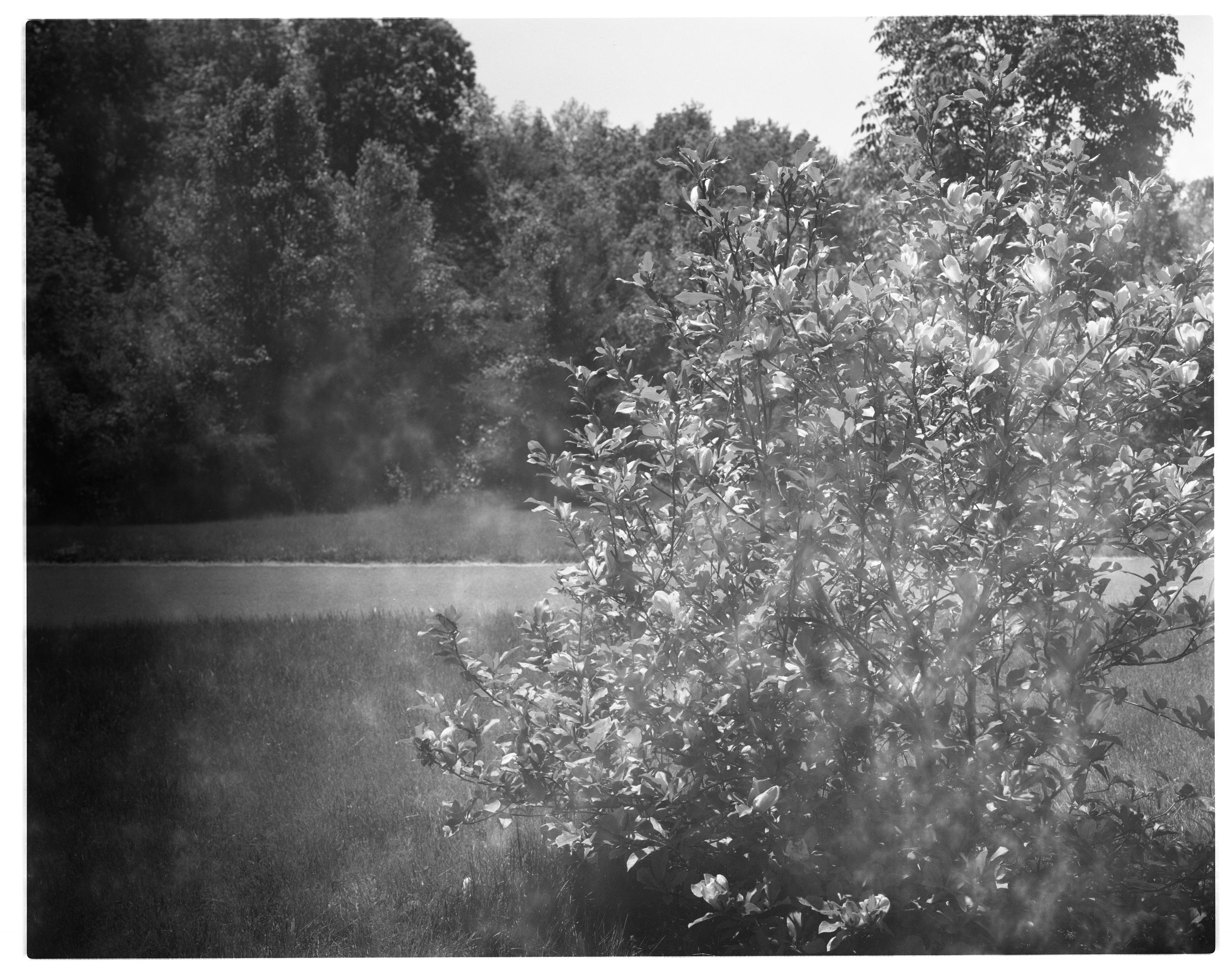

Here is the complete negative with the border.
What is interesting is that, some image formed at all rebate/border areas. The border images are different from the main image, but somehow similar to the plant/grass.
If this is double exposure, then how can the image got into the rebate/border areas in the first place? My 2nd photo has a clean rebate/border area. No image.
I loaded the film in the change tent, double sided Fidelity film holder. Then I only remove the dark slide just before I pulled the shutter. This is the Sinar auto shutter. The shutter was closed before I pulled the dark slide. After exposure, I immediately put back the dark slide. The film is later loaded onto the Jobo reel in the change tent again.
My question is: how can some image formed in the rebate/border areas?

Yeah, all these things are related to age, trust me, I tried to shoot some old 1968 expired Kodak Portrait Panchromatic and go nowhere with it. Plus it was a bear to find development details on it. (Got lots of help here on APUG).
Buy fresh film, if you want to save a couple bucks, check out the Arista.EDU line of films from Freestyle.
