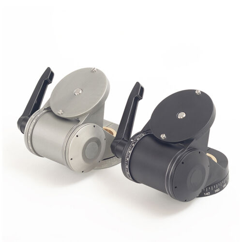

So the real version is just called the Sinar pan tilt head. They’re only available used, and can easily sell for $200-300 in good condition. The Chinese clone is $300 new, and can be bought on eBay:
It doesn’t work well for other cameras because it is only a 2 way—pan and tilt. You get the third axis (leveling the horizon) by rotating the rail inside the rail clamp.
Personally I don’t recommend ball heads on view cameras. Some like them, but I hate them because the camera is large and unwieldy.
Thanks! That looks pretty good, I may just get one of those. Growing disdain for my ballhead. It ended up breaking at some point, maybe a screw got stripped? Doesn't do much of anything correctly anymore...
I do not like ball heads. They are often to loose and the camera can flop around.

the big bogen ballhead is truly horrible(the sliding lever to lock the ball) makes is shift when locking
