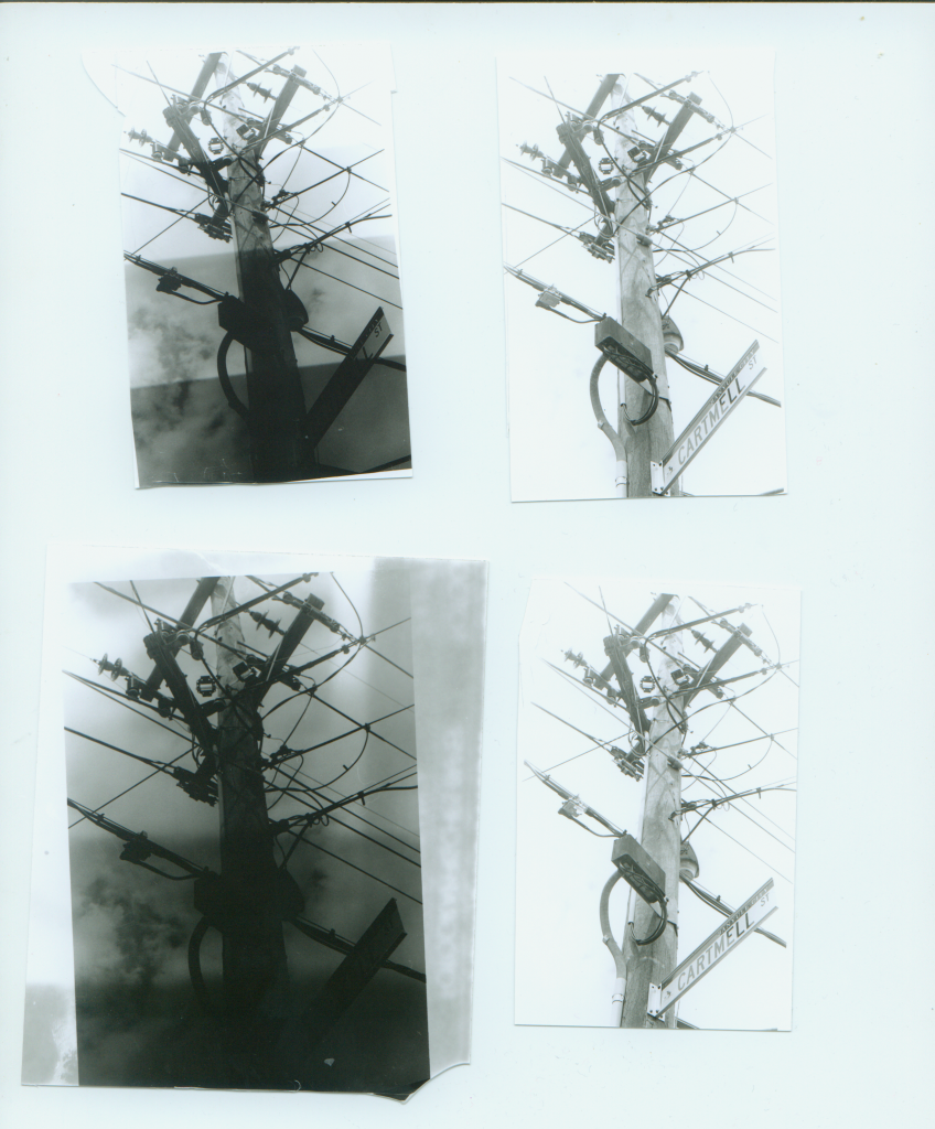

Had a go at some printing tonight. Top left was the test for the right two. Was aiming for the 2nd band in the test for the two "good ones", not sure what happened. Bottom left was another test but I stuffed up the mask timing and forgot to stop down the lens. I'm not sure what the bits off the edge are. I also had a hell of a time keeping things to temperature (may be the cause of some of the later issues). I'd get the developer to 19 degrees and by the time I'd set up the enlarger and exposed the paper, the developer was quickly approaching 21. Probably a combination of me being slow and it being ~30 degrees today. Also, I had to blutack the contrast filter to the lens. No idea how it's supposed to fit properly. There may be a part missing.
Clearly I have have more practice to do, but hey, pictures on paper :smile:

A temperature of 19 or 21 degrees centigrade in the developer should not cause any significant difference. The 21 degree developer might be just slightly faster at reaching completion. Do you have a filter carrier in your enlarger?

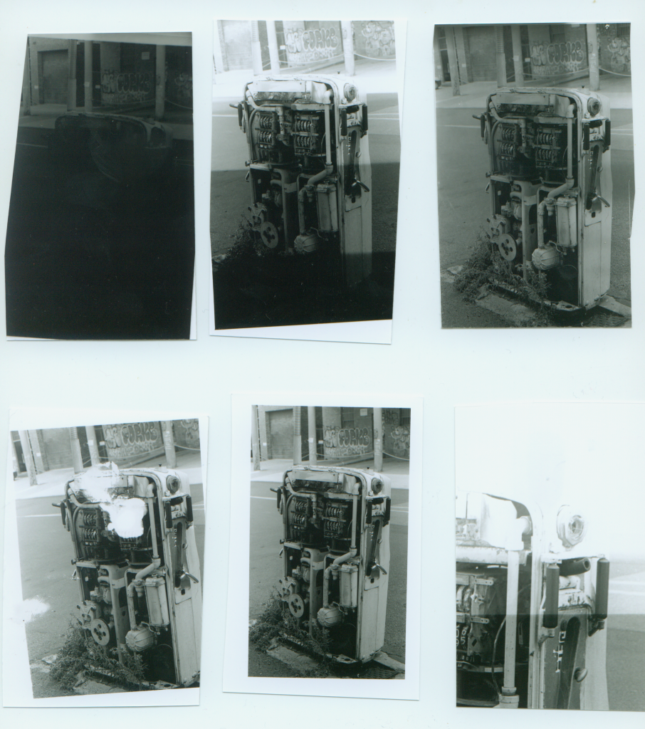

I had another go last night. My scanner seems to be making the images come out blue. The paper looks like proper black and white though.
From left to right, top to bottom, 1. Test strip where I forgot to step down. 2. New test strip. 3. Attempted print. 4. Attempted print #2 (damaged with tongs). 5. Decent small print. 6. Test for Larger image below

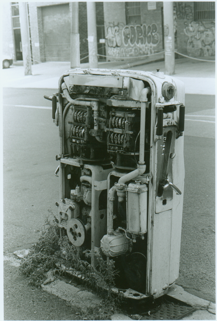

A ~10x7 print.
I'm pretty pleased with how the last couple came out. I'm not sure what happened to picture 3. I expected it to come out like picture 5 did. There's also an almost square bit in the top corner that's lighter. Something I didn't realise but was obvious in hindsight is that the larger pics take longer to expose (same energy, larger area). Is it standard practice to use a larger piece of paper than the desired print, mask and trim or is it common to try to print the entire image to the edge? Is it a personal/artistic preference? It seemed easier once I realised the paper was getting caught on a spring using the mask but means my images will tend to be slightly undersized. Chemical temperatures were around 26C which appears to have worked fine. Though, I did drop my thermometer which introduced air bubbles in the alcohol. I heated it up a couple of times to near its limit and it got rid of them but I'm not 100% sure it's still accurate. I'll need to do some testing.
