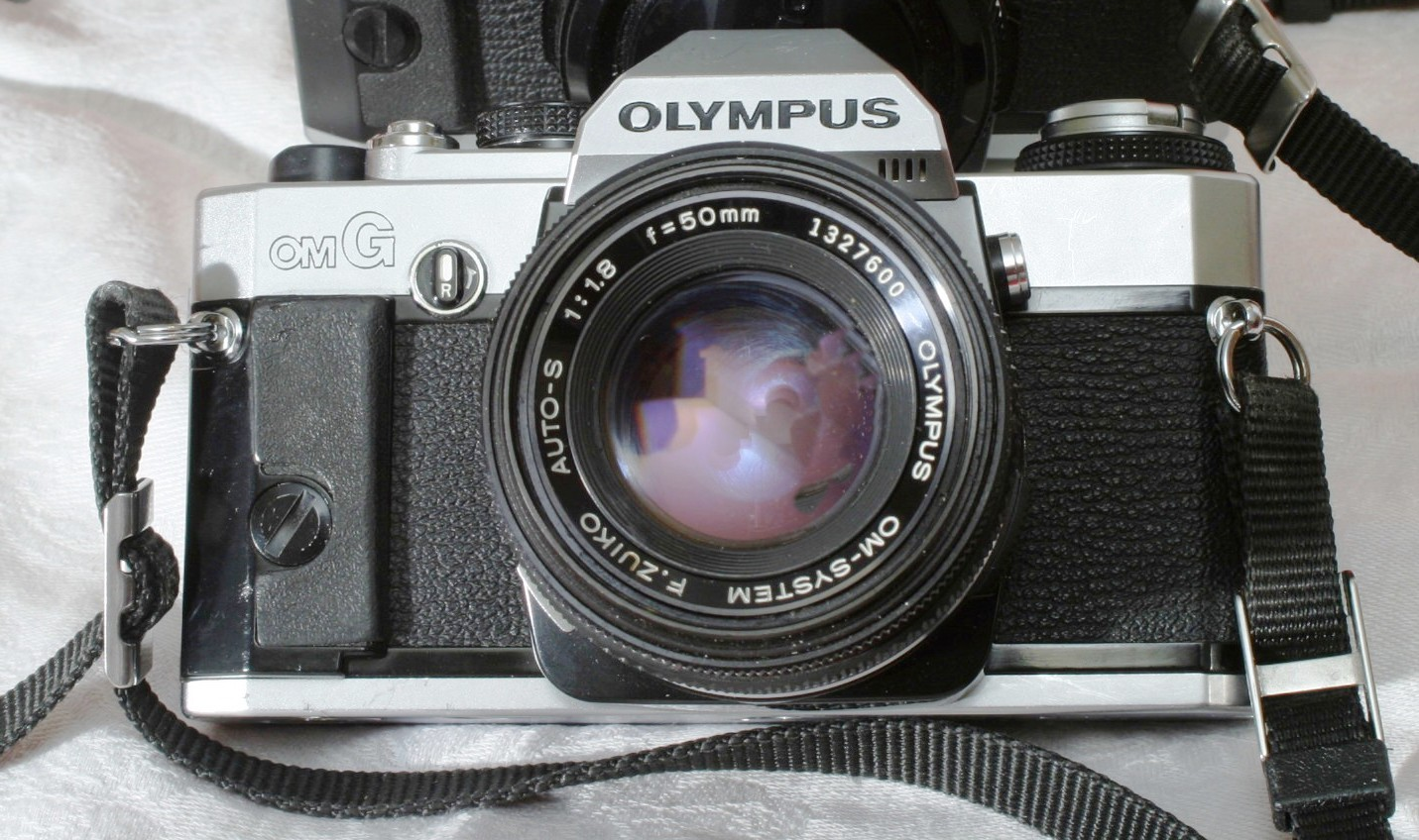

If you have trouble identifying which lens you have on it, show us a quick snap of this sort:

Unless those numbers (1327600) mean something important, this is the exact same lens I am using. It states:
F. Zuiko
Auto-S
1:1.8
f=50mm
575232
OLYMPUS
OM-SYSTEM
F. Zuiko
Auto-S
1:1.8
f=50mm
575232
OLYMPUS
OM-SYSTEM
49mm filters it is!
As for the 1327600, it is a serial number and it means that that lens is a lot later in production than your 5755232 copy!
