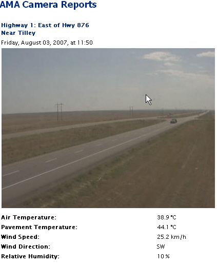

I hang prints from clothes pin until dry, then in old dry mount press to flatten. I used heavy books until I found a beat up old press for cheap but the books were a pain. Screens never worked well for me.
I found the amount of curl varies by paper - Ilford and Kentmere are about the least. Lack of humidity does increase curl and getting high humidity here is difficult which is why I bought a press. Check out the 10% humidity reading in the attached image from a highway webcam 150 km east of here!
