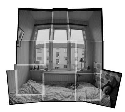

The third attempt was dissapointing. I have put together 11 6x6 negs as a little experiment, please check the attachment. I don't have a LF camera, so this was a "cheapo" way to get slightly larger cyanotype.
Anyway, I coated a paper, let it dry about 20 minutes (maybe not fully), placed the cut up/taped up negs on the paper, put between the 5 mm glass sheets and exposed for 46 minutes. When I rinsed the paper I saw big areas that were indigo colored, ie more blue than the rest of the picture, that were not in the negs. I would call them blotches. I will scan this soon, but the print is drying in the darkroom.

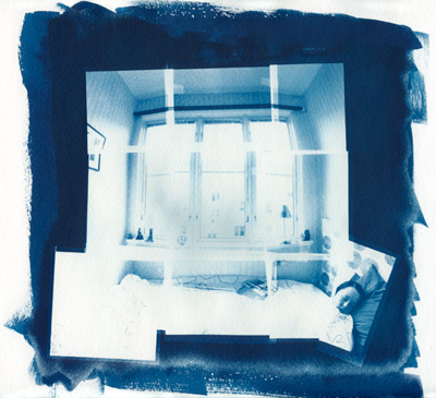

thanks, the blotches are much better now on the dry print. See the attachment. You can see the faint areas of blotchiness in the middle of the print.
So far, the contrast of my cyanotypes is extreme. These negs are quite dense, but not so high in contrast. I don't expect any detail in the window, but the walls and the cover should have some I think. Acidic first bath could help maybe? Is lemon juice OK? I can't really buy any acid, unless you can find it in a grocery or hardware store.
I will do a new try on this one, with drier paper, flatter negs and more time.

Looks like uneven drying before printing to me.
You should be able to purchase white vinegar in a grocery. White vinegar is basically weak (~4% IIRC) acetic acid. That will work to acidify rinses. Citric acid is sometimes sold where they sell canning supplies. Either should work.
Joe
Standard white vinegar in the USA and Canada is 5% acidity; diluted 1:3 it's just right for stop bath (though more expensive than Kodak or Ilford indicating stop baths). I'd dilute about 1:31 (an ounce per quart) to use it in a cyanotype first bath; you want it just barely acidic, to kill any alkalinity that might be present in your water.
BTW, that blotchy area does look a lot like what I've seen where I left liquid sensitizer on a piece of paper and it dried extra thick; perhaps an area of overlap in your brush coating?
