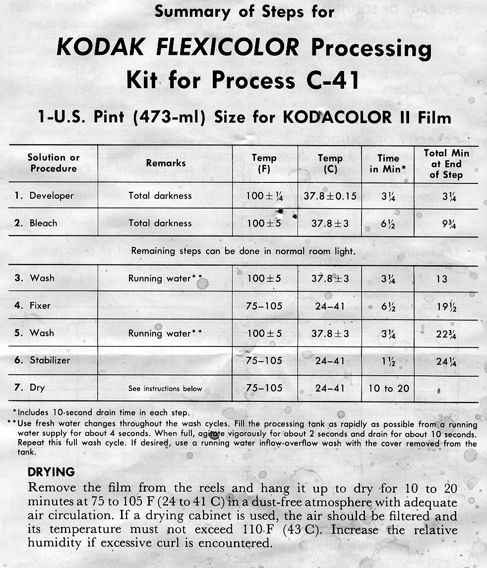

Attached is the official C41 process recommended by Kodak for small tanks. It is different for deep tank and automated machinery and it is slightly different if you are using bleach III which is green, as opposed to the red bleach which is used in the attached document. Bleach III requires less time.
