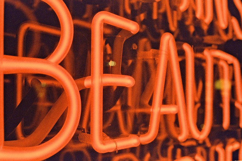

So I developed my first roll (Ultramax 400) in Kodak Flexicolor SM chemistry…using those weird F1 and F2 processing units. To my surprise: images came out without too many noticeable problems. I inspected the negatives for streaks and ripples, scanned a few images to get used to the workflow, but honestly I can't tell if I did a good job or not.
Why? I have to edit these pictures a bit to get them usable. I end up: reversing colors (of course), doing a curves adjustment to set black point (because the film base is so dark/orange), setting white balance, setting levels. How would I know if I were having color shifts? What are some problems I should keep an eye out for?
Here's a sample from the roll. Let me know what you guys think. :smile:

Congrats. It's a nice shot. Probably not the best subject matter for anyone to judge your processing (beyond confirming that there are no streaks, spots, etc. -- at least in this one frame). Also, the fact that you adjusted contrast and color balance after scanning doesn't help. You've introduced too many variables.
One thing I found helpful was to scan my own C-41 processed film alongside a lab processed film of the same type and subject matter. And I mean scan the whole negative -- sprockets and all. I placed them side by side on the scanner -- three frames from one film on top, and three more on the bottom. Then I took a high-res scan of the six frames with the "no color correction" option checked and compared. It's hardly scientific, but it might help.

Neon light has a pretty narrow and spiky spectrum so it's basically impossible to tell from that shot if your process is OK because the green- and blue-sensitive dyes were probably not exposed at all. You certainly couldn't tell if there was crossover or anything subtle like that.
If you want to evaluate whether your process is working, you need a range of identifiable colours in the test scene and a fairly full range of greys from very-dark to nearly-white. The usual answer is a Gretag-Macbeth chart, or you can just use your hand (for skintones) and a handful of primary-coloured and white plastic things. I went with my hand, a blue plastic bottle, can of coke and a box of HP5+ to get the primary colours, range of greys and skintones. Light it with a flash if you have one, otherwise direct sunlight.
There's a C41-scan article in my FAQ (link in signature), which may or may not help you...

I honestly didn't post that image as an example—I was just proud of it. :laugh:
I think I'll go the route you did, or just look through the roll for better test shots. I had a picture of different fruits that I wanted to post, but I scanned it at such a low resolution by accident. Whoops. I think I'll post it anyway. Here goes:
