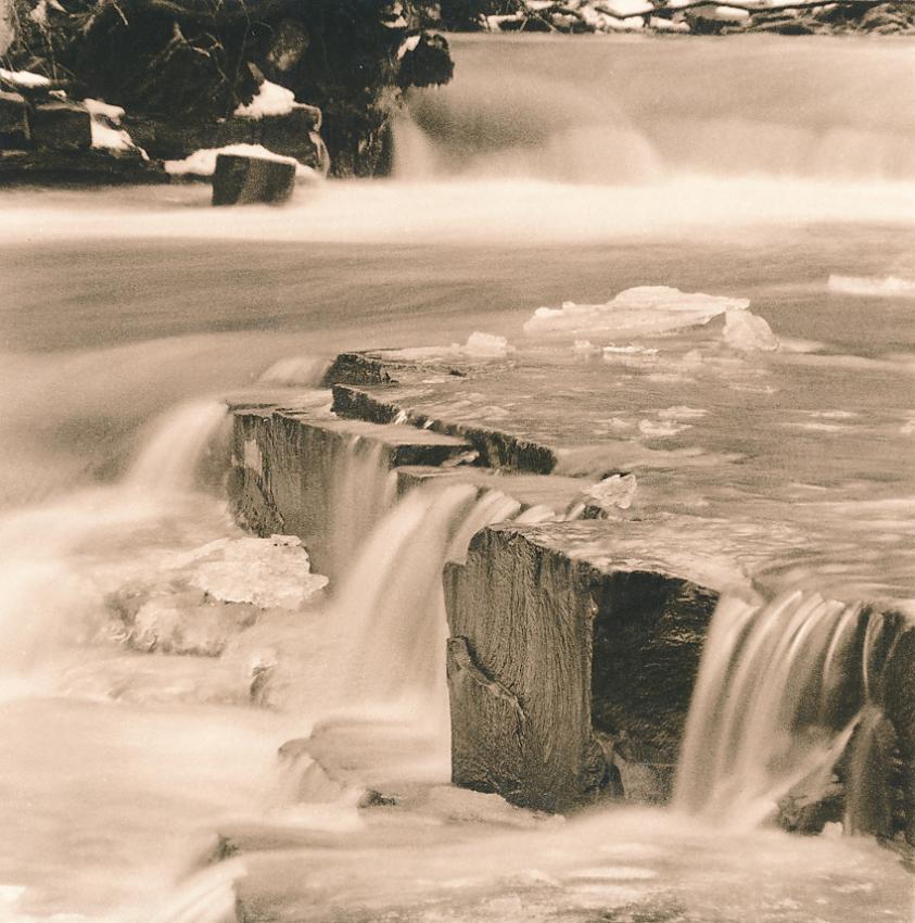

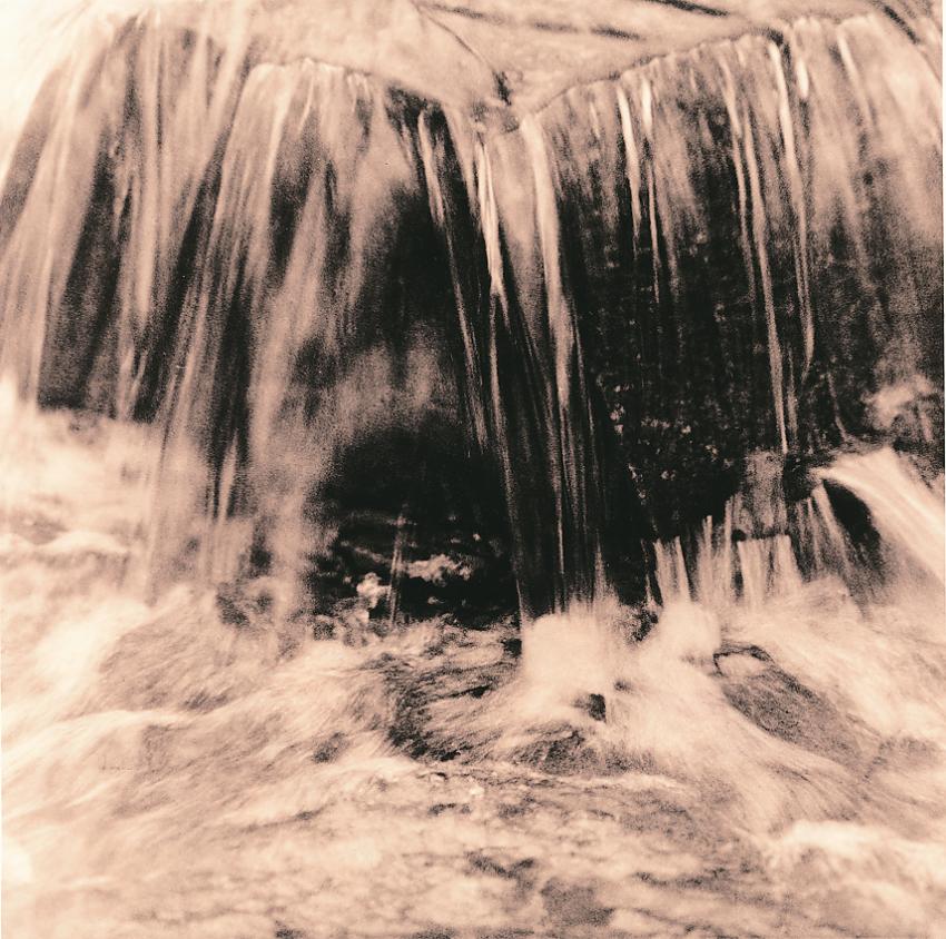

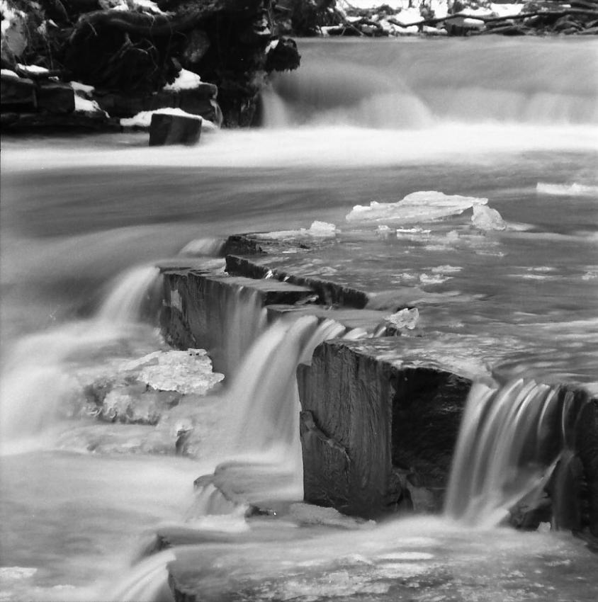

My first attempts at lith printing. I used Arista Lith 1:24 as recommended and the temperature was 19.8C for #1 and 18.3 for #2. I've included a scan of the original image for comparison.
#1
Luminos Ultra Gloss Paper (unknown expiration)
attachment.php
attachment.php
#2
Kodak Ektalure expired 1977
attachment.php
attachment.php
What do you think?

The results with the Luminos paper appear more like classic lith but the Ektalure has a charm of it's own. If you want more contrast but less colour use shorter exposure times. From an image point of view I prefer the second one (Ektalure) it is just more interesting photograph. It would be even better imo if you were to crop out the upper stones/land part (just where to foam starts).
Nice results for your first try.
Thanks for the advice. When I get time to try it again I'll revisit the crop as I try out different temperatures and dilutions.
I've ordered Tim Rudman's Master Lith book and look forward to trying more of this.

I think your exposure and snatch point were right on the money. As a first attempt, I'm pretty sure you had no 'old brown' with which to season the developer. Your second attempt should give you at least a little different result (the beauty of lith).

That's correct, I started with fresh developer. I did keep what I had mixed up so this weekend when I'm in the darkroom I'll be trying again on the same negative and maybe 1 or 2 others.

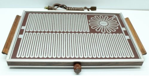

I got one of those vintage food warmers on eBay and it's great for experimenting with warm developer, and (what Mr. Rudman calls) "hot and strong" selenium toning. Which you really want to do outdoors, by the way - ouch!
