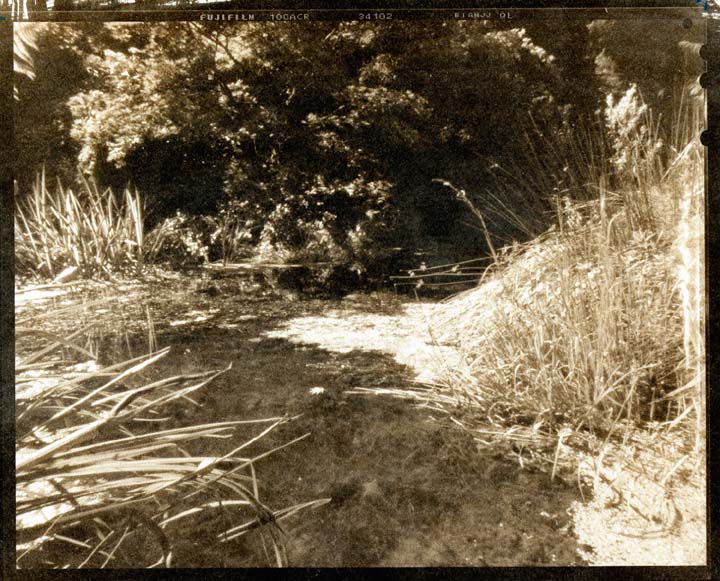

Did my first argyrotype session last night. PVia, I think your main problem is the paper. I did 3 prints on Crane Cover and 1 on Arches Aquarelle. The Crane prints did not bleed at all, but the Arches bled like crazy in the Selenium toner (1:100 dilution). It didn't bleed much in the first water bath though, so I'm going to try the Arches again without toning to see how it looks. I think the Crane prints look pretty good (best one attached). I'm using the B&S chemicals and exposing with one of the spiral black light bulbs they sell. My exposure time on the posted image was 9 minutes. I did experience some bleaching in the fix, but any loss was regained in the dry down - the highlight area in the center of the image was nearly white when the image came out of the fix, but regained a good amount of detail when dry.
The negative was a pinhole exposure, 12 seconds on Acros @ EI 50 and developed in Pyrocat-HD.
