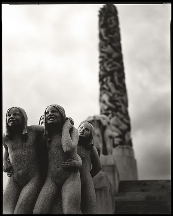

Here`s a quick scan of the first contact. :smile:
Thank you all. Can`t wait to use some better stuff the that cheap Jessops RC paper I bought to start with.

Vigelandsparken? Nice static subjects :wink:
Just you wait, we'll have a Norwegian chapter of the ULF'ers union soon :D
