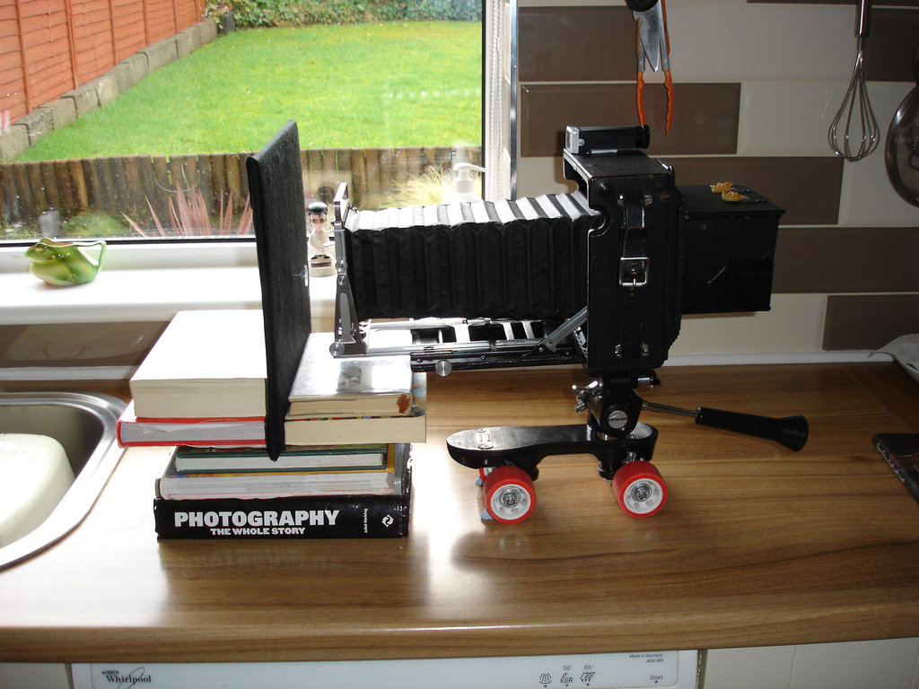

Here's the set up...notice the Blu-tac chocks on the wheels. :laugh:
JP
Old-N-Feeble
Feb 22, 2012
6,805
South Texas
Ha ha... that's awesome!! :D

Mick Fagan
Sep 13, 2005
4,434
Melbourne Au
Brilliant tabletop photography.
Maybe you should post this onto one of the myriad of Whirlpool forums.
Love the Italian red racing wheels.
Mick.

Old-N-Feeble
Feb 22, 2012
6,805
South Texas
It must be a Footrrari!!
