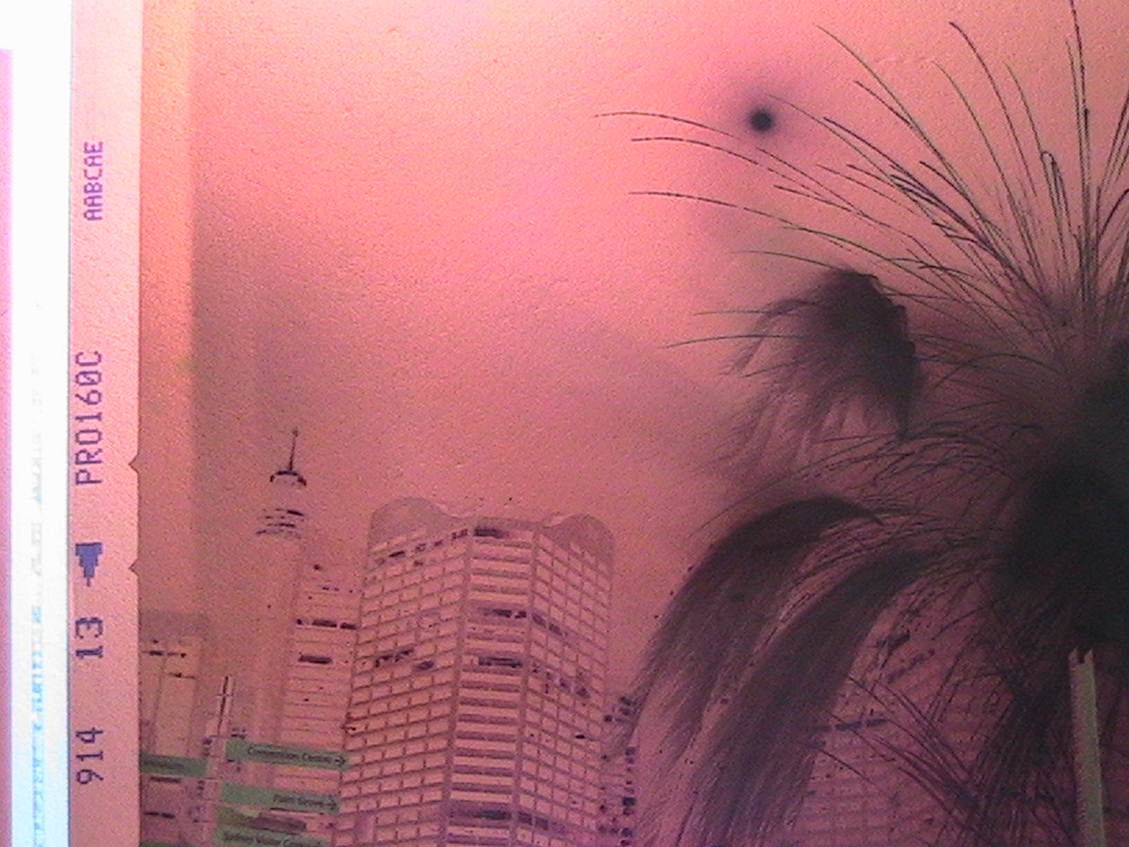

Okay, here is a digisnap of a neg. Sorry, I don't have a neg scanner. You should be able to see the outer light band on the left edge, and then one slightly darker to its right.

It looks line the light seals need to be replaced. You can have them installed by a Hasselblad repair person like David Odess [http://www.david-odess.com/] or KEH; or purchase them from B&H or KEH. Q.G. can direct you to where a good set of installation instruction are located. Remember to use the darkslide to hold the replacement parts while you reassemble the film back.

Could also be a reflection of a strong lightsource.
Something like this:
In this image the sun is just outside of the frame on the right.
Not pretty. But also not a defective light seal.
Seals need replacing every now and again though. And it can't hurt to put a fresh one in your magazine.
Steve will post a link to instructions how to change them. I dare not, because he will be mad at me for promoting the site. :wink:

Thanks Steve and Q.G. Q.G., that's what it looks like to me. This back is not that old (well, 1993 as opposed to my 1977 back), but maybe does still need new seals.
