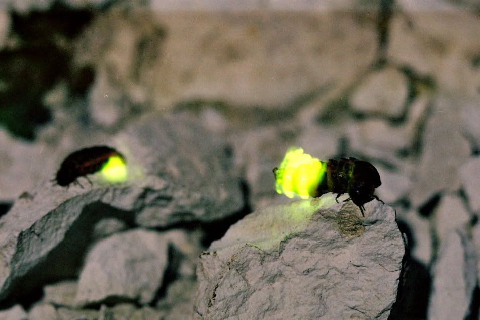

I once spent quite some time optimizing for fireflies and here was the technique I figured out: long exposure (a second or two) for the firefly's blinker; short flash exposure to freeze the body and boost the ambient. Occasionally the two exposures will coincide satisfactorily and the blinks will be in the right place. Sometimes the blinks will be trailing the body which is also quite amusing. This usually worked best with the flash synched to the rear curtain. Take a lot of shots and you'll get a few keepers.
I never bothered trying to get them in flight, for obvious reasons. Instead I captured them, rattled them gently to disorient them, and then set them on a leaf where the camera was set up. After being deposited on the leaf, they will be a bit dazed and will move slowly, but their blinking can be triggered by warm breath.
