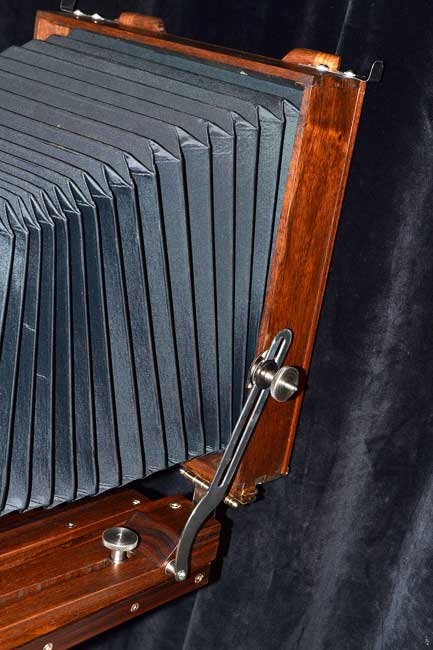

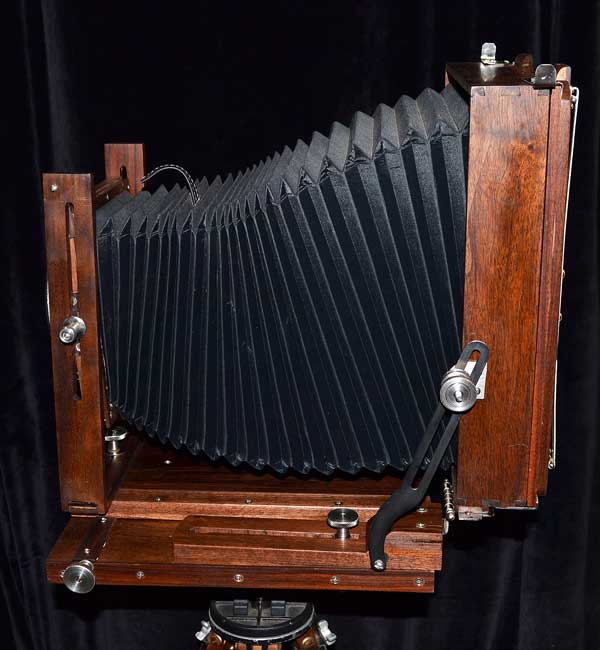

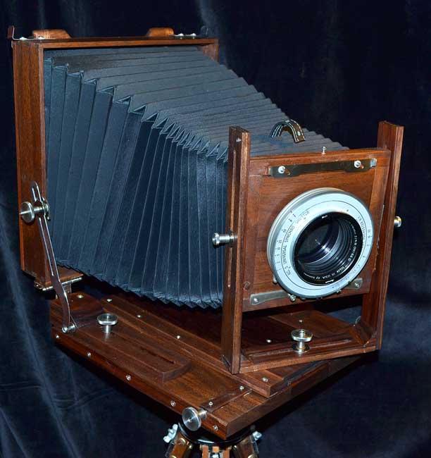

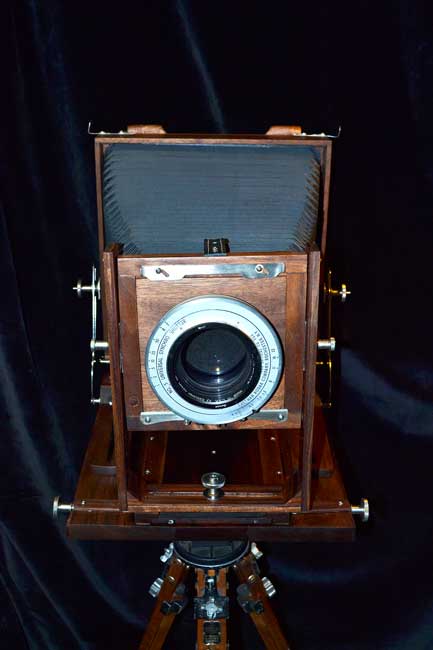

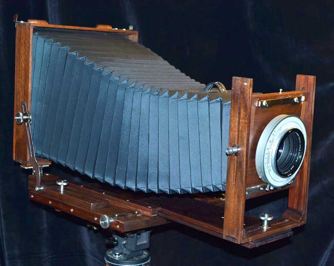

51 days into the build I have it done. I built this in the hall way of my apartment. The pictures of the construction are in another thread but this is the finished product.. I'm happy with the movements, sturdiness and look of this my 4th camera build. Time to clean up and go shoot this baby!

Jim, Looks very nice, of course this is no surprise. Yes get out and shoot, you can clean up later.

Excellent!
I initially thought this was a non folding design but I can see I was wrong now. Would I be right to assume that it folds up Chamonix style? i.e. you detach the front standard from the focusing rack to collapse the bellows before folding.

It's a work of art you're quite a craftsman. Did you use hand tools?
Mostly hand tools. My router was used but my small dovetail saw was a great help. My trusty dremel is always at work along with my cordless drill and bench top drill press. basis stuff nothing fancy.The finish is hand sanded with diamonds to 2,000 grit and then several coats of paste wax to protect the mirror finish.

I'm more like Steve, I start out with one design and then find a nicer solution and before you know it I'm redesigning it again. I see it as a design / build process that sometimes inverts into a build / design process. My project is an 11x14 with film holders. I know what you're thinking, did I cut once or twice. Well in all this confusion I lost count. But I feel lucky! Like Jim I have Rosewood for my project. One plank here and a half dozen due in today. I agree with Jim that stainless steel looks great on rosewood. The jewelry makes it pop like trim on windows. The bellow looks great, but the money shot is missing. The rear view, back, picture. Did it come in under or over weight for its class? It looks great Jim!
14 x 36 in (flat) next? :wink:
Paul and Curt, thanks. When you build cameras you sometimes make some parts over again.... at least I have in the past and did so with this one. I came in overweight I feel. It is 10lbs. My Seneca Improved is 10.8! Wow! I'm underweight by 1/2 a pound1 Cool!
