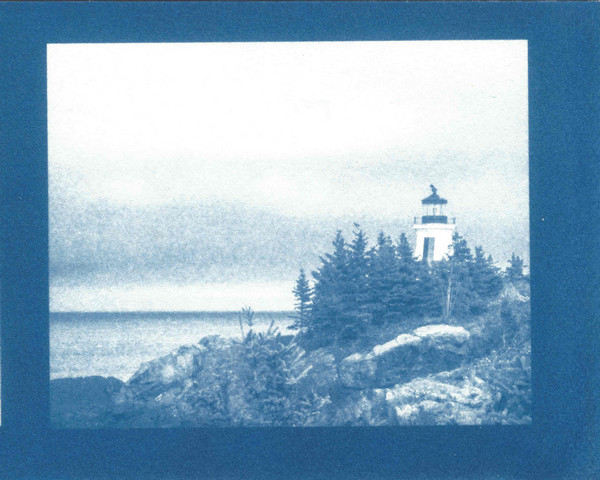

Over the past several months, I have posted the results of several experiments/test that I have done as I relearned/adapted the printing of cyanotypes after a hiatus of about twelve years and after moving from a full darkroom/lab to my basement without much infrastructure.
I think that I have reached the point of making some finished prints and present here four of them for your comments and critiques. All of these are scans of 4x5 prints made from digital negatives.
#1 -- Still Life with Bottle
#2 -- East Quoddy Light (Campobello Island, NB)
#3 -- Gosport Chapel (Star Island, NH)
#4 -- Mill Building (Harrisville, NH)

Nice looking set, Frank. It is an accomplishment to have figured out all the little idiosyncrasies of the process and be able to print a few images with relative consistency. I am still in the idiosyncratic stage...
Are these all done on same paper? No. 3 seems to have coarser grains than the other, is that the paper - perhaps cold-pressed?
The last one has greater contrast and higher Dmax than the rest, so technically that one is the best, except for the slight highlight blow-out which probably can be fixed on the negative. What was different about that?
Appreciate if you can share what your final set of processing conditions were.
:Niranjan.

The first three prints are all on Fabriano Tiepolo (290 gsm Soft White) and the last one is on Fabriano Unica (white).
Thus it is interesting to me that you singled out #3 from the rest. I wonder if I coated the "wrong" side of the paper for that one. The two sides of the Tiepolo are very subtly different, so I could have easily coated the "wrong" side.
I am beginning to settle in on these two papers as my "go to" papers. I am not pre-treating either of these papers to remove any carbonate buffer present.

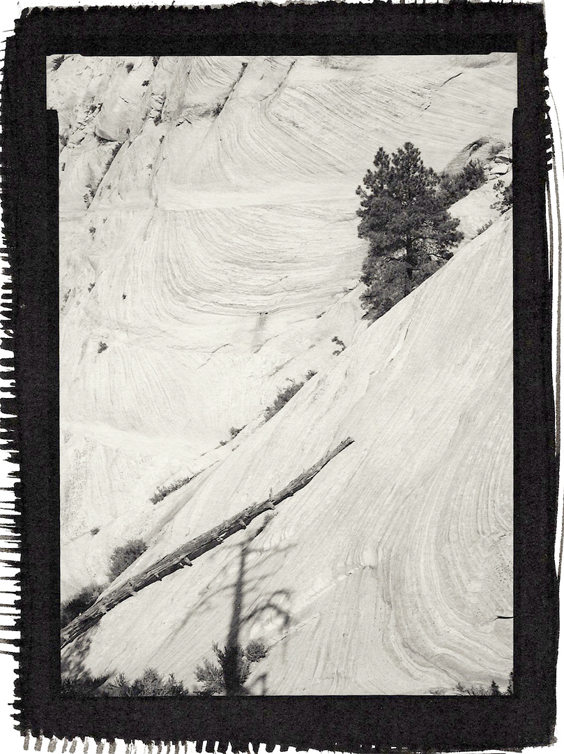

I settled on Hannemuhle platinum rag. No more farting around with acid baths.
I have been using it for pt/pd prints...though I like the surface of COT320 a little better (the look of the surface texture, primarily). But I working on a 4-foot (50") x 33 foot roll of the Hannemuhle Platinum Rag, so I better like it!
I am not using Tween -- that is one difference between cyanotypes and platinums...the cost of the material. With platinum, one wants sufficient, but minimal penetration of the solution into the paper...if only to keep all that expensive metal close to the surface of the paper where it can actually be exposed and seen!
Cyanotypers...how much solution do you apply for 100 square inches (about the amount for an 8x10), if you measure? I use about 40 drops (10 to 15 drops per ml) of my platinum/palladium/ferric oxalte solution for an 8x10 and would like to compare, as cyanotypes might be in my future again.
PS -- I start coating with a rod and after 4 to 6 passes with the rod, I have set the size/borders, and I finish with a light touch with a brush. Below is a 5x7 print made that way (rod is 5.5" long). Zion Nat.Park, 2018, pt/pd

I have a 'magic' brush. Works great...but so has some other brushes...just got to watch out for those errant hairs.
I have not had a problem with curl -- but then I cut a large number of sheets out of the roll and put them under some weight for a couple of days. I believe I coat the inside of the roll...slightly less texture than the outside. A slight curl works if one remains has coated easily with a rod or far.
