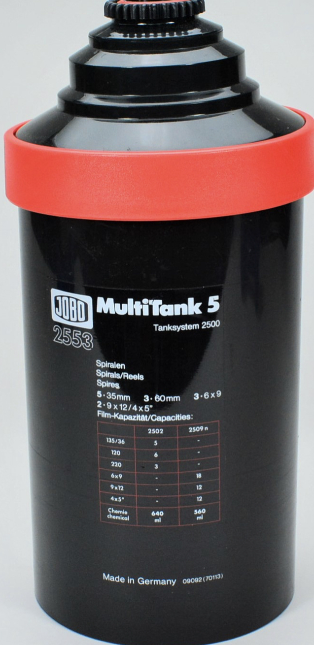

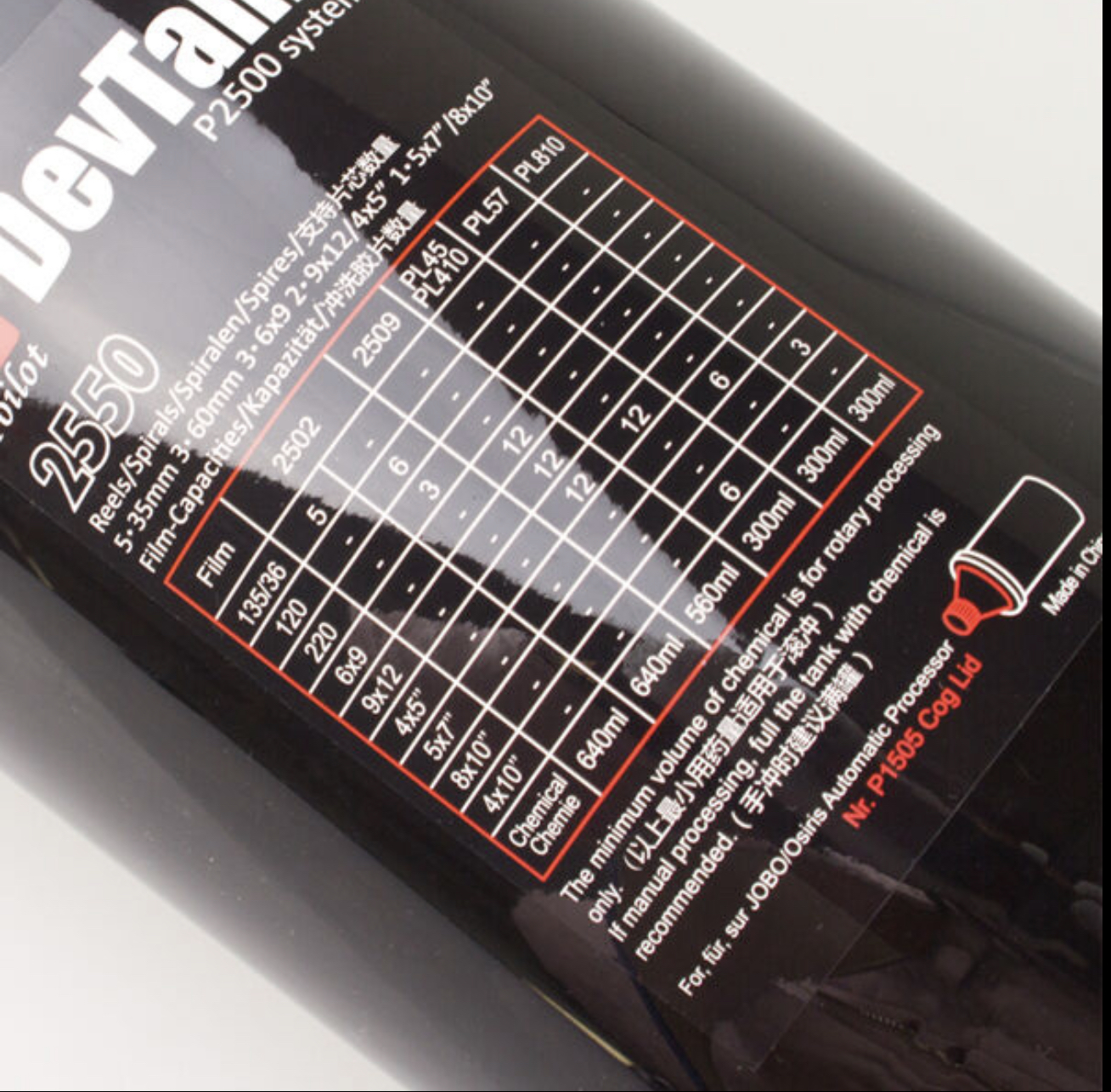

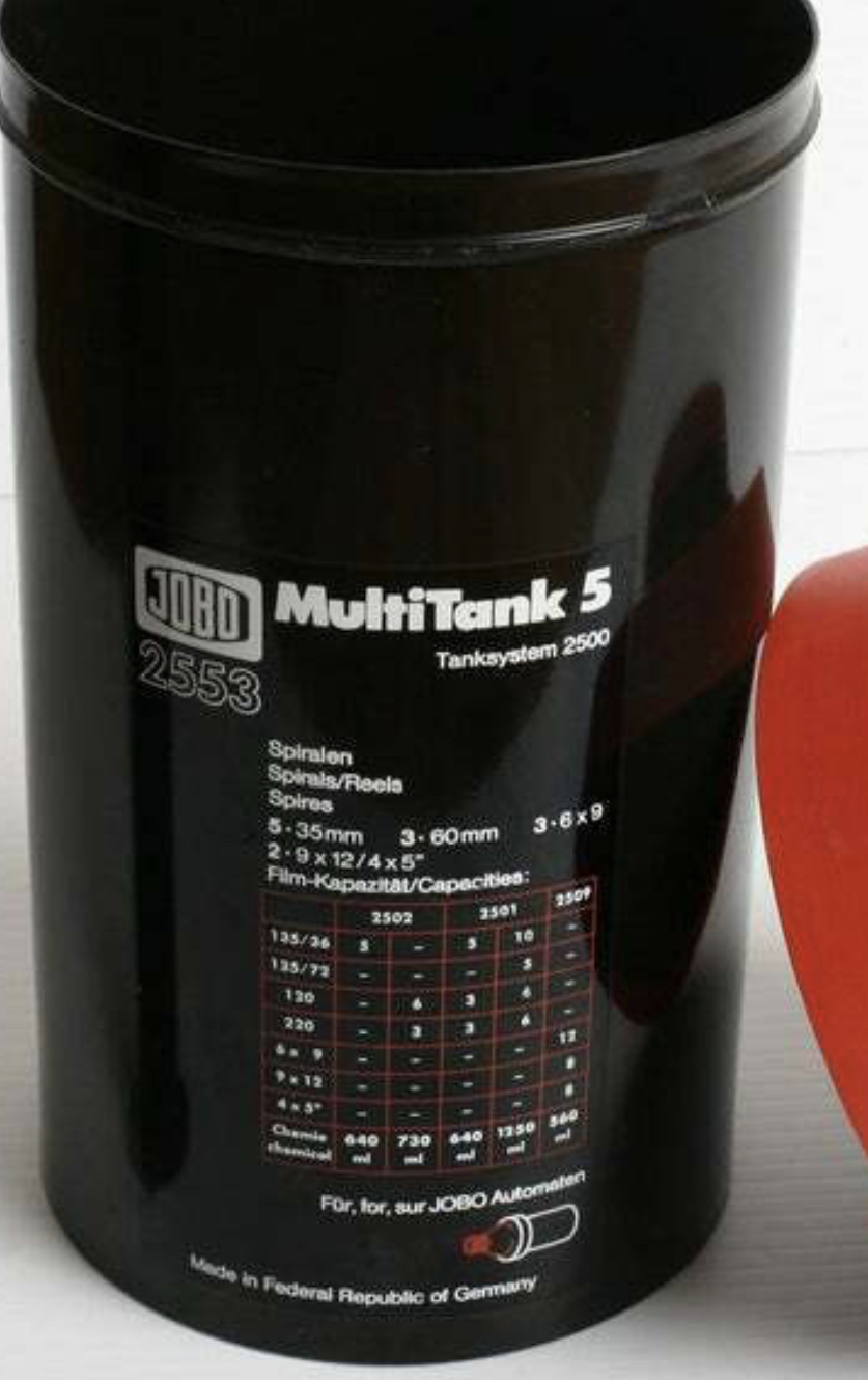

I have a couple more questions for you experts —- why do I see the Multitank 5’s list as accepting 6 rolls 120 ( 3 x 2502 reels) and volumes are sometimes listed as 640ml and at other times it says 730ml for 6 rolls? ( see pics) maybe there were problems using only 640ml and they upped it? If it takes 730ml, then I think it exceeds my CPE2 capacity.
And to confuse it more - anyone know what these "Piolet" branded tanks are ( see last pic with made in China label) ? They are on ebay for about half price of the Jobo.
And finally - what tank will hold 2 x 2502 reels in 120 configuration? I’d like to be able to develop at least 4 rolls if not 6.

The choice of combinations depends on how many rolls of film will you process at a time.

I wish I had an answer to that minimum processing volume discrepancy. If no one chimes in, the answer may be in the Jobo newsletters that are available in pdf on internet.

The 120 film capacities sited I believe are assuming two films on one reel. There should be a red tab on the reel to keep them from overlapping.
