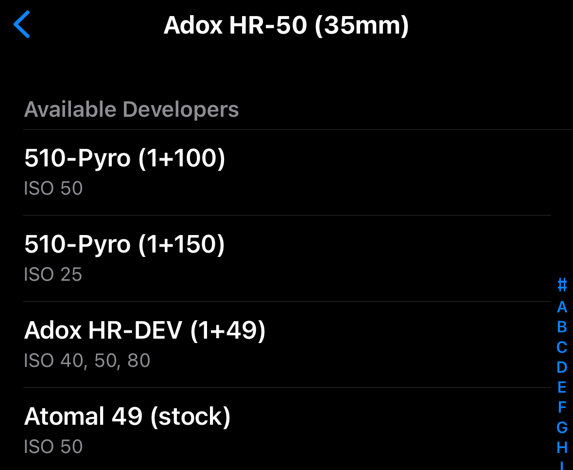

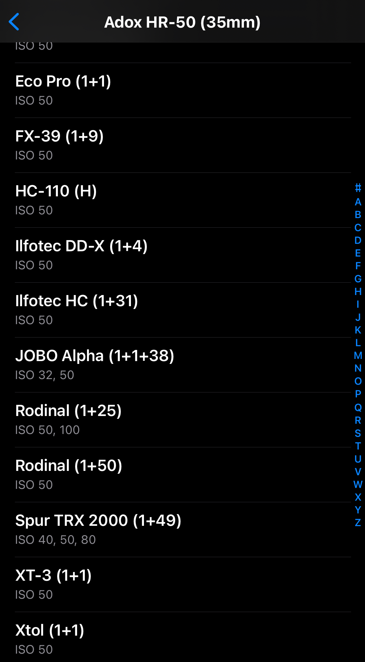

Normally I would suggest checking the Massive Dev web page, but it currently is not working for me..
Massive Dev chart
I have the mobile app and I’ve been using it very often, but unfortunately there’s no time for it as well.
the only ones are the ones I’ve attached
