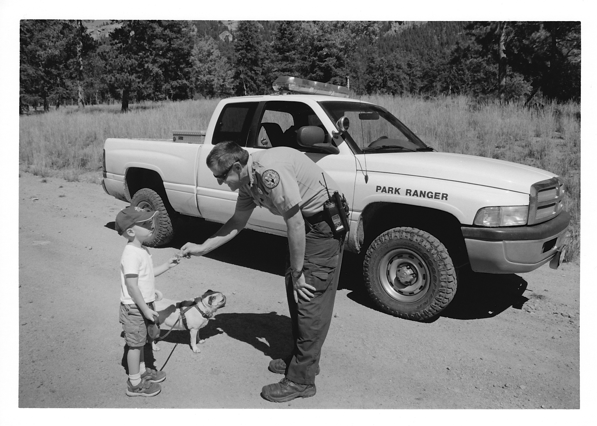

I'm struggling a bit to find a B&W film I like in 35mm. At least I'm trying to find a 100ish speed film I like. I've settled on Tri-X for a 400 speed film.
I used to like Plus-X, but in reality, I rarely tried anything else back then, so I was just blissfully shooting it and making do. I always worried about grain then, and had vague misguided thoughts about how my photos would be so much more awesome if they were razor sharp and grainless.
I've gotten over that silliness more or less during the last few decades of shooting digital instead of film and having all the grainless sharpness I could want.
Getting back into things I've shot some of my old Plus-X, and it prints OK, but that well is almost dry.
I tried some T-Max 100 developed in D76 full strength. It's easy to print, I don't have any problems with highlights in the shots that I've printed.
Here's a Deere resting in a mountain meadow, for an easy example. It's printed on Ilford RC multigrade. It got a little contrast adjustment in Aperture after I scanned it, but otherwise looks reasonable. It's almost all mid-tones, and they seem fine.
This was shot in splotchy sunlight through some trees, and the highlights on the face and shirt aren't blown out and didn't require any burning. This is on Polymax DW FB paper (the well is almost dry there too... I'm hoping the Ilford FB paper is as good).
This one has good shadows, midtones are fine, the sun reflection on the white truck is still visible, and the white shirt doesn't look too bad either. This is on the Ilford RC paper too.
All of these were easy to print, but they have the feel of a digital image with the black and white effect, which I can get with my pocket digital camera and a click or two in Aperture. The dynamic range on the TMax100 blows digital out of the water, so I'm not thinking of giving up or anything.
I got excited about FP4+ with a more traditional look, but after an hour of messing around with different grade filters and thinking of an extensive burning/dodging plan for a simple landscape shot, I'm getting turned off of that film a little, even though I like the grain and look of FP4+. The subjects were very different (perfectly clear day with stuff close up for the TMax vs. long views through some atmospheric haze with the FP4+), and I probably could have saved myself some trouble with stronger filtration on the FP4+ shots, but I'm still feeling frustrated. I don't have anything worth scanning from those rolls yet.
I don't quite understand what I'm bumping into here. The critique of Tmax with hard to use highlights seems to be no problem for me, but I have more of an aesthetic issue with it (which I can probably get over). I expected FP4+ to print easily, but I'm finding that it's more of a challenge than expected.
I don't know if there are any good suggestions other than to keep trying. Other than this forum, I am working in a vacuum with a home darkroom, so it's good to just discuss this stuff on here with all of you.

So I locked myself in the darkroom with the FP4+ for a few hours last night. It turns out the problem was that I picked a tricky negative to print the first time. With other shots on the roll, I was able to get satisfactory prints.
It definitely gives me a similar feel to Plus-X, so I'm happy. I see a use for both TMax100 and FP4+ now that I'm not worrying about finding a film that I will like. They have different strengths and weaknesses. Thanks for the suggestions!

Jack, that very big dog in the bottom left of the second print has been so annoyed at having his picture taken that he has swivelled his head 180 degrees and that look in his eyes suggests that you should not get any closer to him.
Mind you he might just have a complex about having no tail. Insecurity tends to breed aggression:D
pentaxuser
He's a slow mover though. I wouldn't worry about him. Maybe even slower than my pug.
Well I can't see anything wrong with Jack's lenses based on his two pictures in post 15
28mm f/2.8 series E. It's no 28mm AI-S, but it's worked fine for years so long as I keep the sun off the front element. I'm happy with it, especially since it only cost about $75 when I was a student.
The others are with a 55mm f/2.8 Micro Nikkor, and that thing is almost a laboratory instrument.
