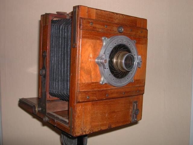

scootermm said:
... I like the idea of the lens panel. but am afraid the copal #3 shutter size limits this a great deal.
The iris lens mount on this camera opens to 90mm. It would have no problem with a lens mounted in a Compound #5. So the available shift is only limited by the size of the lensboard mount.
BTW this is not an FKD, but an "original" antique German 13x18cm plate camera. Easy to see where the design of the FKD's came from!
