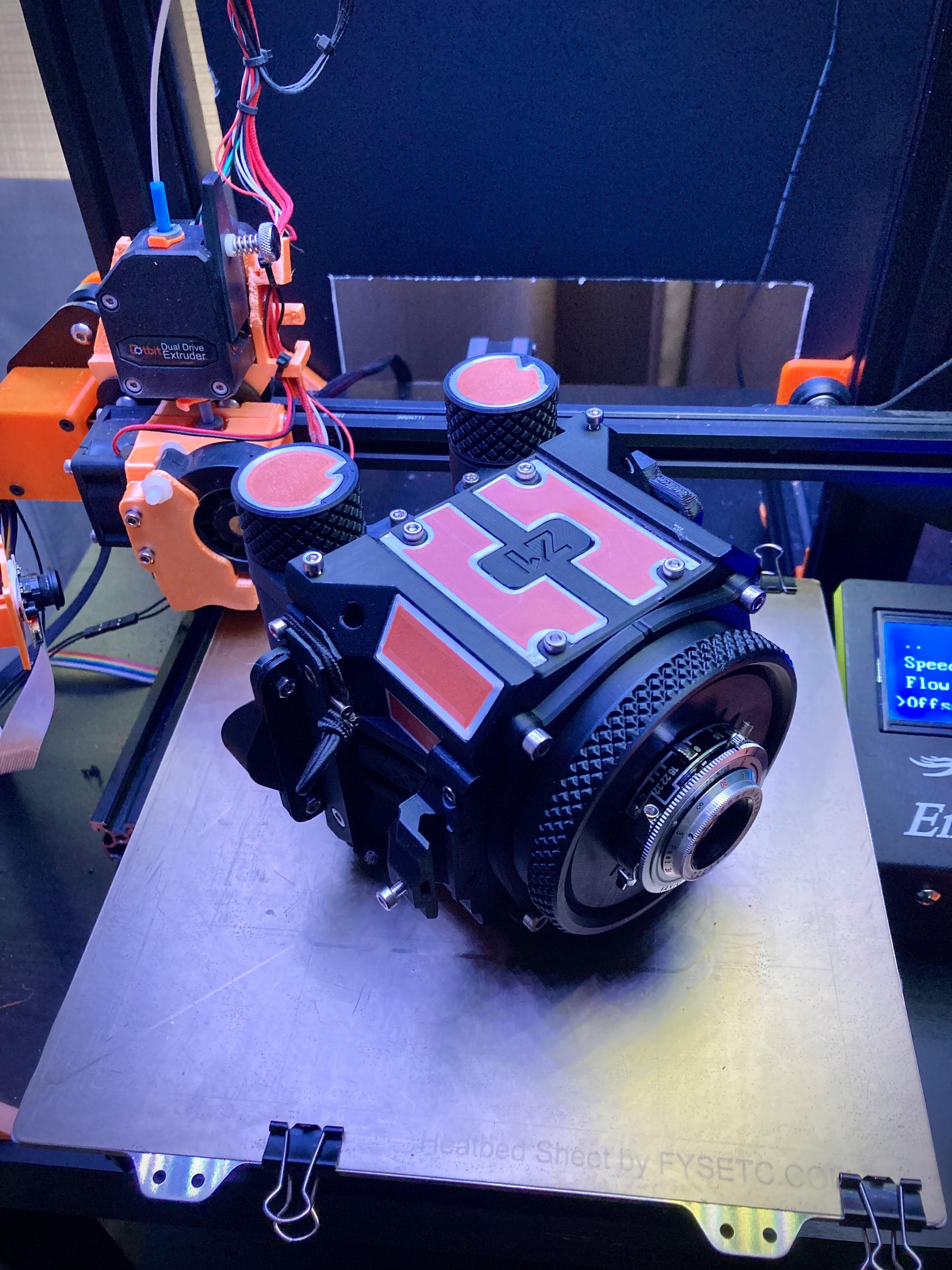

Question on your 3-d body already printed: how do helicals come out on today's 3-d printers? Te printers I was around a few years ago were lower end, and resolution was, well, not the best. Maybe the materials easily clean up. Do you need to build in extra material and then plan on removing the jagged steps? Or maybe resolution is such now that this isn't an issue.

@Dan Daniel To answer your questions, I have attached a picture of the camera with the 3D printed 6x6 back. The back needs some work. I'm likely going to make some pretty substantial design overhauls and try printing another one. It gets the job done, kind of, but the dark slide situation is insufficient to keep light out when the back isn't attached to the camera.
As far as the helicoid, it's surprisingly good. It's not a precision machined feel by any stretch. It's large and fairly rough. This was printed with 0.2mm layers on my printer (which is basically standard resolution). I could go down as low as 0.08mm layers on my printer if I wanted to, but that would nearly triple already pretty long print times, and the way the helicoid is designed, I think any improvements in smoothness would be marginal at best. I will say this - it is rugged and effective, and I have never had a problem getting critical focus with it. It's just not at the level of "so buttery smooth it's a joy to use." I have toyed with the idea of putting in some lithium grease or similar to see if that improves the feel, but precision is already not an issue, and introducing something like that would probably lead to problems down the line. I am primarily a nature photographer, so even when I'm being careful, my Goodman Zone gets exposed to plenty of dirt and dust in the air that would pretty quickly make its way into the helicoid and convert my lubrication into valve grinding compound :wink:

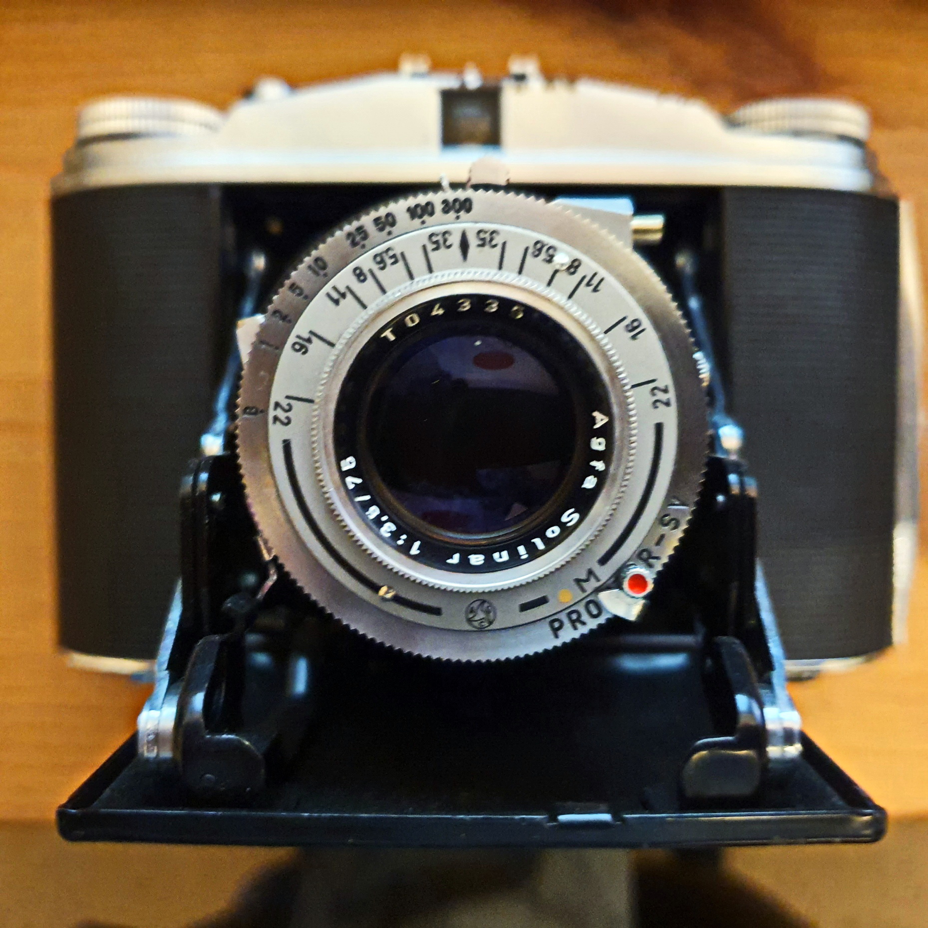

Camera arrived yesterday. Lens focus was, amazingly, not stuck. Bellows were also free of pinholes. Both firsts for me.
The lens was dirty but cleaned up great. Shutter was gummy and sluggish. A little disassembly, flushing and cleaning with denatured alcohol, and a lot of exercise, and it’s working now. Every single speed is either 1 full stop or 1.3 stops slower than nominal, but consistent from firing to firing. So it’s a functional shutter but not stellar. I will be putting this lens into a different Compur Rapid I have that has nearly perfect speeds.
But first I’ll run one roll through this camera as-is. Seems like a shame to have a nice copy of a Jsolette with Solinar and not use it at least once. This camera body will get the Apotar lens I have, and most likely be sold at some point.
Really happy with it overall! Can’t wait to put this lens through its paces.
