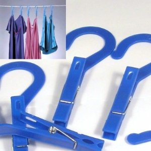

And these dollar store items work well for hanging the film to dry:

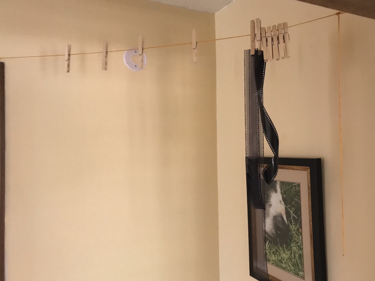

I've always found the clips I use are heavy enough.
If you have a hook in the ceiling or wall (just make sure there is enough clearance so the film won't touch the wall, binder clips will do the job just fine. One clip at the top of the strip, the hook goes through the handles, and one or two at the bottom to weigh it down. You can also string some clothesline or rope or monofilament from the showered to the shower curtain rod or whatever you have, just put the string though the clip handles first.
Don’t overthink it. Clothes pins and string worked for Eddie Weston and Ansel Adams….

I use clothes pins to hang the film too (and the prints). It would be helpful if you had a spare roll of film to practice with in the light before loading the reel in the dark.
