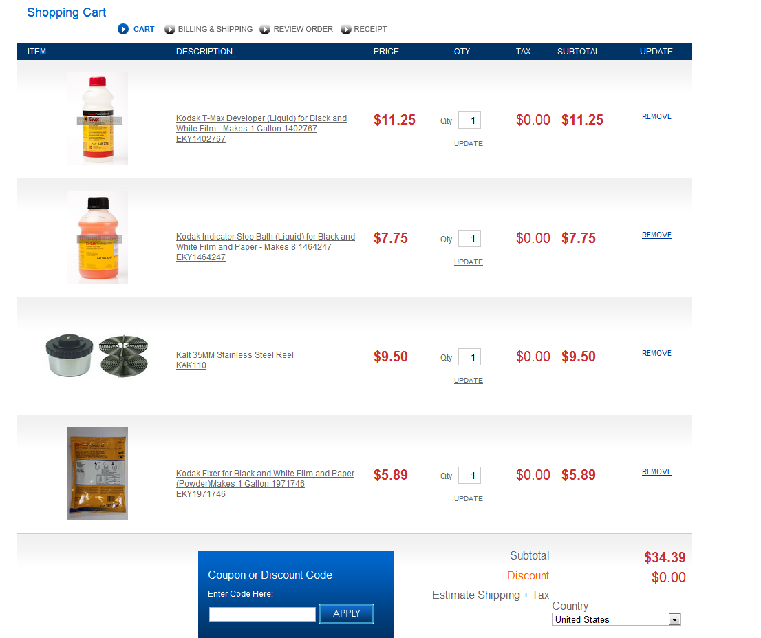

I'm going to be developing some black and white 400tmax.
Also, can I re-use any of these chemicals? I don't think I can reuse the developer, but I believe I should be able to reuse the fixer and stop bath.
Any help is appreciated greatly.
