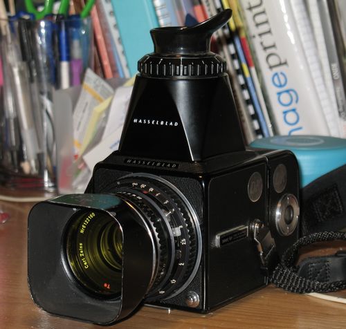

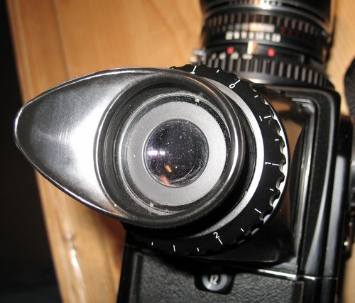

So did mine. I found my Hasselblad not a pleasure to use for that reason alone. Some people rated highly their so-called chimney finders. These magnify but not by so much that your eye can't cover the entire composition; they also correct for near/far-sightedness, -3 to +3 (by turning a ring on the eyepiece).
I finally got myself an ugly chimney finder too. It makes sooo much difference in composing and focusing. This must be one of the most underrated accessories. Drawback is that the thing doesn't fold- it always sticks out and makes the Hasselblad significantly bigger. (You can take it off but then you have to remove the back first.) It's light though.
Might be an alternative for the OP as something in between a WLF and the prism finder.

Some pictures of the chimney finder. It's ugly alright but really useful. They go on ebay for something like 25-60 euros depending on luck, state, etc.
One other advantage compared to the WLF is that your head helps stabilize the camera; with the WLF everything is sort of floating. Especially helpful when one's hands are not super steady (me :sad:).
