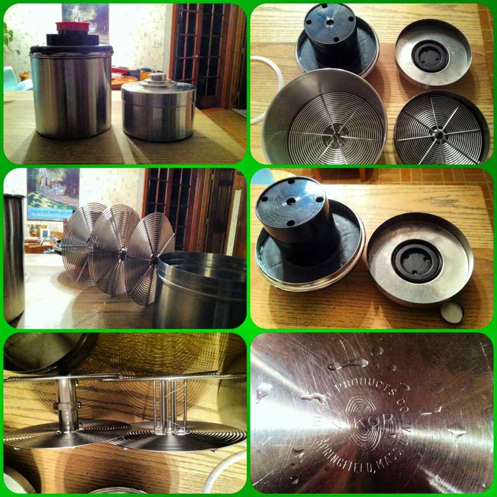

OMG!! I just found one too, the Nikor one :smile: excited and posting my excitement!
It's much smaller than my home made one...
