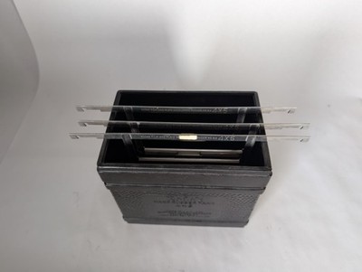

Processing-wise I have some paterson tanks and 3D printed film holders, one that holds 3 sheets, one that holds 6 sheets but not the way I want, and a 4-sheet version that I've been dabbling with for a while.
Way to go ... I've been using trays for years, but sometimes it gets a little tedious in the dark.
blee1996
Jul 25, 2008
1,326
SF Bay Area, California
Be aware of some 3D printed film holder for Paterson tank: they look like will work well, but might have some under-development issues near edges. You can run some test sheets first before committing to more important sheets.
On the other hand, Mod 54 reels works well for me in Paterson tank.
