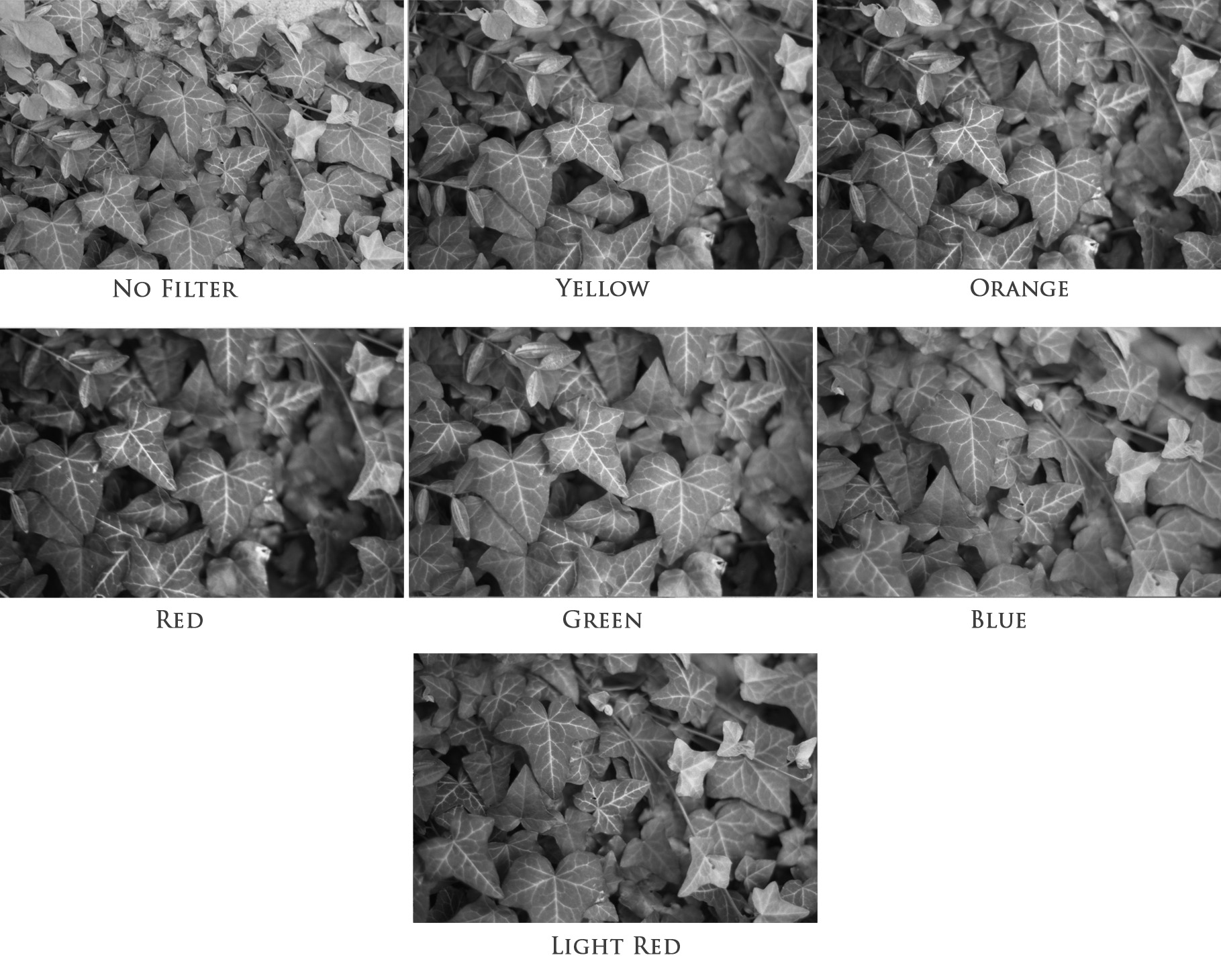

What filter colour would you suggest to use when photographing close up green leaf and brown dry leaf on black and white negative?
I mean... Does Yellow or orange gives good results on green leaf? Does red filter gives good results with brown dry leaf?
I have Yellow, green, Orange, Blue and Red filters and I am avoiding spend money buying more filter. :smile:

I look through the filters. The best results will come through experimentation; since it is a still life, and you already have the filters, expose the scene through each filter and see which gives the best print.
jeffreyg
Jun 12, 2008
2,649
florida
Red and orange will yield a "darker " green leaf, yellow probably a slightly "lighter" green leaf since some yellow filters are yellow-green, green would give you a "lighter" green leaf . Check to see what yours is. The red and orange will probably have the opposite effect on the brown leaf. Try all as suggested as well as no filter which may turn out the best. Generally I would use a blue filter if I wanted to accentuate fog in a landscape under foggy conditions. Most of the time red, orange and yellow would be used to "darken" the blue of the sky and bring out the contrast of clouds against the sky. You might also consider orange to increase contrast in a landscape and green to lighten up green in a landscape. Some will use filters such as red to lighten a ruddy complexion or for a rather white skin for Caucasian subjects.
Remember that in B&W you are dealing with values and the brown and green leaf could actually have the same value and with no filter come out in similar shades of gray so using a filter might be necessary for your purpose.

The filter choice might be different depending on the picture. If you have a green leaf on a dark background you might want to lighten it. But against a light background you might want to darken it.

Haaa, I'll give you the answer.... Green. My favorite filter for close-ups of green things.
Really you have good answers, try what you have and pick your favorite. It might be different than mine.
But at least once you must get down on the ground and look sideways and up at green plants through a green filter.

I got a set of filters, and a color wheel. Filters on B&W will lighten like colors, and darken opposite colors. Try different filters, using the color wheel to get an idea what they will do and take notes of the filter and the exposure you used for each picture. Then, when you have your prints, you can decide which filters you like in which situations.
The general rule is to use the lightest i.e. least dense filter which gives the desired effect. Giving more exposure will slightly lessen the effect, less exposure will slightly accentuate the effect.

May it is not a good test but here it is:
I actually like the oranfe filter the best.
It was shot with Ilford Delta 100.

Back to the filter question, always remember that filters don't lighten their own color, they hold back (thinner on the neg, darker on the print) other colors, holding back their opposite (or complementary) colors the most. Objects of their own color remain relatively unaffected. It's the application of the filter factor, increasing exposure, that make it's own color objects heavier on the negative, or lighter on the print, depending on how you decide to print.
It makes sense to me that the orange worked well for Marcio, as it has some yellow, related to green, so, not too extreme, but enough to enhance the value differences within the green leaves.
