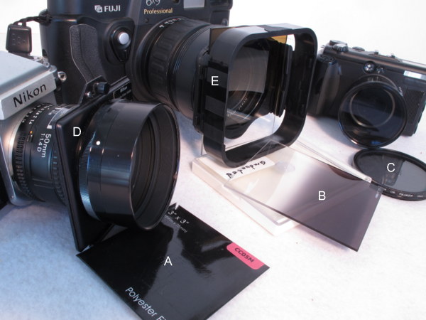

I use glass, plastic resin, and gelatin filters.
The filter brands I use include:
Nikon
B+W
Cokin
Hoya
Tiffen
Vivitar

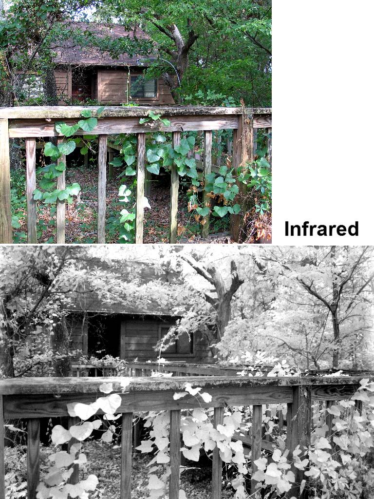

For black & white landscapes, filters I may use include:
red
orange
yellow
infrared
neutral density
https://flic.kr/p/am5qaX

https://flic.kr/p/eDwiuv
