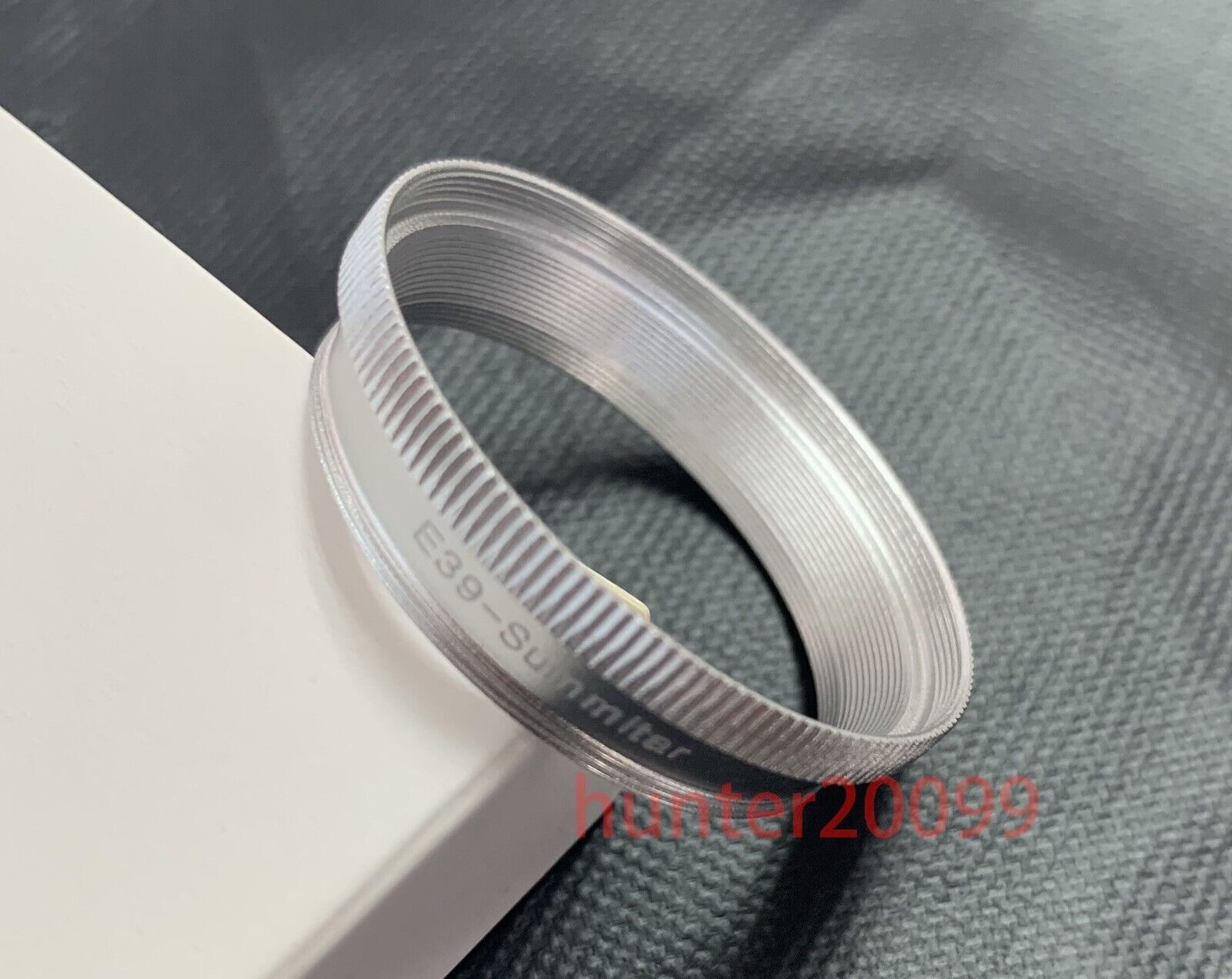

Looking at how Leitz went about front ring design on this Summitar 50 2.0 lens, dedicated filters were made to match. Filter thread is in deep recess and filters are built to match. One thing to get the original filters, but there is also an adapter made in China (not sure if Leica ever made one) that will allow 39mm filters to mount. Problem I see is vignetting issue. Looks like a rue thing if any number of filters are stacked, but even with just one optical path becomes even more restricted.
Has anyone used this kind of adapter? LINK

While at it, I'll be interested to know hands on experience with one of these Chinese made adapters, quality wise. Looks like Leitz made it in brass, Chinese is aluminium, probably prone to jamming.

Adapter appears to be pretty close copy to the original.

I use a Chinese made Rayqual adapter (with the same lettering as your adapter) all the time on my Summitars and wonder just why a fuss is being made about them? It screws on smoothly, it screws off smoothly, it takes 39mm filters and they in turn will take a lens hood and have never seen any vignetting. I also have the equivalent Leitz adapter and it works in exactly the same way. Is the problem you own and you want to stack a lot of filters for some reason, in which case get a 39mm to 46mm (or whatever) step up ring and mount that on the adapter then add all your larger diameter filters (I do not endorse filter stacking).

I also have one of the Chinese adapters to mount 39mm filters on a Summitar lens. It fits fine with no issues. But I opted to buy genuine Summitar filters. They are reasonable price on Leica standards, and they let me mount the odd-ball but effective barn door hood.
Another option: you can buy a Series VI adapter for the Summitar and use those filters on this and other lenses.

If you end up getting one a typical Summitar could have seventy years of crude pushed into the adapter/filter threads from years of lens cleaning because they are so close to the front element. So it's always worth cleaning out the thread as much as possible with naphtha or Isopropyl alcohol before screwing the adapter in.

I have one; mechanically it's fine. With a single low profile 39mm filter it doesn't vignette detectably for me. However the one I received at least was not painted, it was bare aluminum througout. The Summitar is very prone to flare and the reflections with this adapter in place made the flare very obviously worse to the point I'd consider it not really usable without using the big box shade. After I painted the interior surface of the adapter ring (carefully masking the threads, of course) it is fine and quite useful.

The thing is the original Leitz adapter spoken of was factory blackened on the inner wall.
For the off-spring version clearly that needs to be done by own means. Might as well take the thing to local shop for black anodising process, or I believe this can be done at home too. Definitely a much nicer finish as a result.

You can buy ones that are already black on the inner surface, which is probably easiest given their low cost. I was just surprised by how unmistakable a difference it made with the Summitar.
