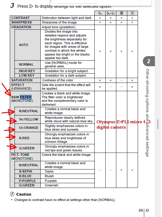

I use a viewfinder app on my iPhone to check framing before I set up my camera, and one of the features it has is the ability to display the scene in black and white. It would be really cool if it could display the scene as it would appear with filters.
Many digital cameras provide that option. You switch to BW mode and then select the color filter. You use the camera as a director's viewfinder. I use my Olympus E-PL1 micro 4/3 digital camera for these things. See the instruction manual section below. What's nice is you can snap the picture and save it for reference as a jpeg while saving the RAW in color at the same time without the BW and filter effect. The digital camera can be used to select the right lens on my LF camera as well as doing preliminary composition. I record the settings verbally in video mode for transcription later at home and use it as a meter as well since it has center, matrix and spot metering options.
