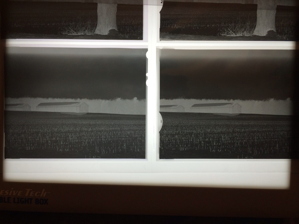

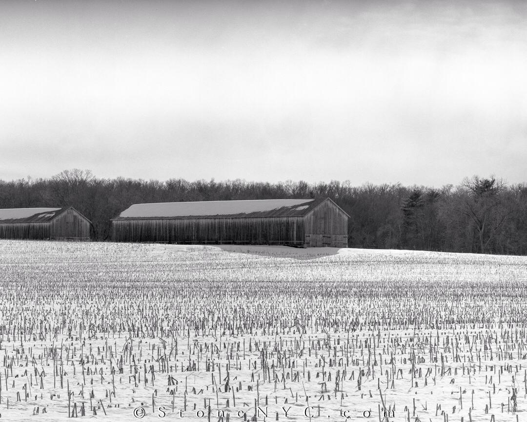

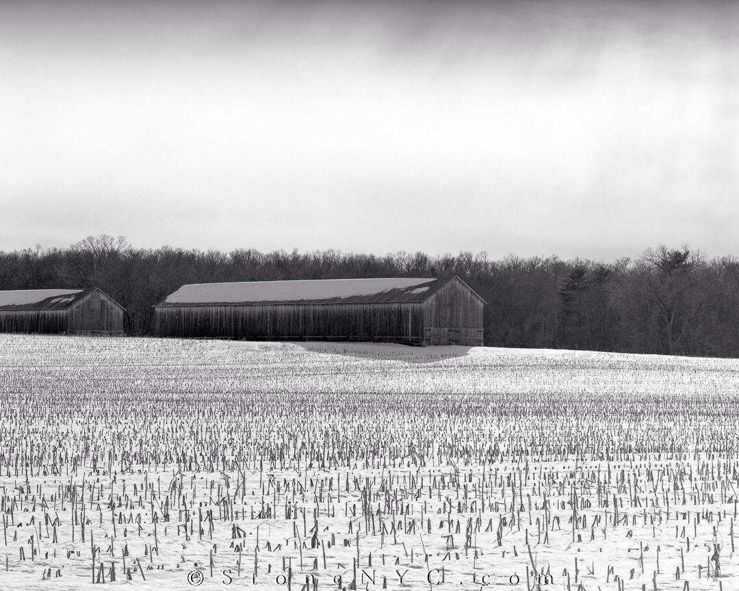

FWIW I just did a comparison with a red filter of TMY-2 and FP4+ and the negs and (scanned) images look almost identical...
Here are the results. Sorry not printed optically :sad: but thought it might be helpful to post none the less...
FP4+
TMY-2
Both with red filter, both in DD-X both with exact same exposure (2 stop difference obviously).
FP4+
TMY-2
Thanks for posting this.
Just to satisfy curiosity, did you set contrast (or: black and white points) equal to each other or to taste individually? The only "real" difference I see is the TMY-2 frame going a bit darker in the deep shadows, hence my question.
Thanks again for the comparison.

I essentially let the scanner do it's thing, but from my experience, in a given scene that is comparable, the scanner will give the proper comparison... This MIGHT help....
Yellow filter
Red filter
To qualify, the clouds did change the exposure slightly and you can see the sky is more exposed in one as the sun "burst through" just as I was shooting, but relatively speaking I think this will be helpful to see as a reference, also obviously there's no accounting for differences in development times where I might have over developed, etc, still getting used to the rotary processor times.
