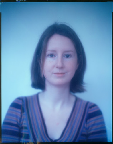

Finally got around to actually shooting a few sheets on sunday. This is one of the results. This is basically just inverted and levelled. No relative channel adjustments made.
This was filtered with an 85b and the recommended starting filtration on the pack of Supra Endura that I got, 65m and 55y.
As you can see it's still heavily blue. So do I add more magenta & yellow ? Or less ? I'm guessing more, but just on the offchance that I have it backward.

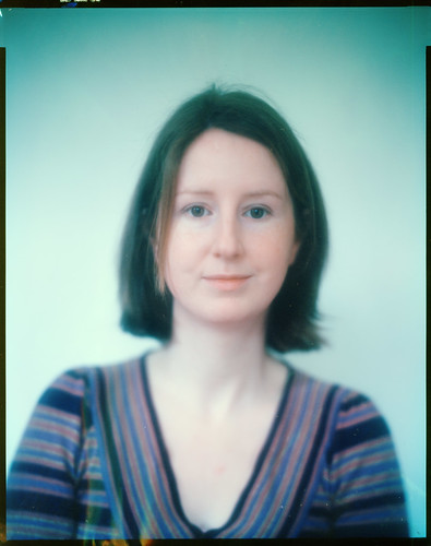

In addition there's obviously a heavy degree of IR sensitivity on the paper. So I guess I need an IR cutoff filter or something similar ? It makes colour balancing the resultant scan pretty much impossible. Here's a more processed version of the above ...
The IR does add a sort of glow to the portrait though :smile:

No there's no IR sensitivity at all, but as PE said earlier, it's very sensitive to UV.
Nice results!

I had a layer of UV filtration mixed in with my filter pack. The reason why I say it's sensitive to IR was looking at the red channel of both images, the one of my sister isn't so bad, but this is the one of my dad:
Dead Link Removed
I've never seen such a pronounced effect shooting B&W film with (say) a 25a, or in the red channel of a colour negative. I've seen similar though shooting people with SFX with its near IR filter in place. It seems very pronounced.

In RA-4 paper, the red-sensitive layer is the topmost layer. So, the layers are in reverse order compared to film. And there is no UV filter layer. UV exposes the red layer.

Ok, so given that there's one there, and I had one in my filter pack aswell, could it have been some IR response in the paper that caused the red channel to look like that ?
Also, returning to the original question :wink: Is it more magenta/yellow filtration required do you think ?

For color printing, it is a Heat Absorber / IR filter that is needed as well as a Wratten 2B.
Color paper does have a slight sensitivity to near IR. The UV sensitivity is high due to use of Chloride in the emulsions. The UV filter is there mainly for dye stability.
Therefore, both are needed.

Ah ok, so that probably accounts for that. Doing a quick search seems to indicate that actually blocking IR might prove troublesome (or expensive ...). Something like a hoya HA-30 looks as though it could go some way toward solving the issue though ?

Actually it seems from the datasheet that the cyan-forming layer sensitivity peaks at 700nm, so there is just a little IR sensitivity there.
