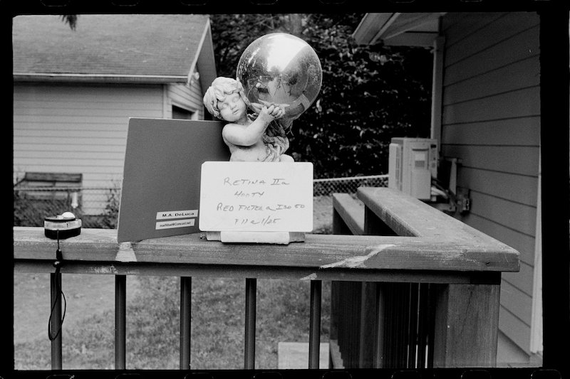

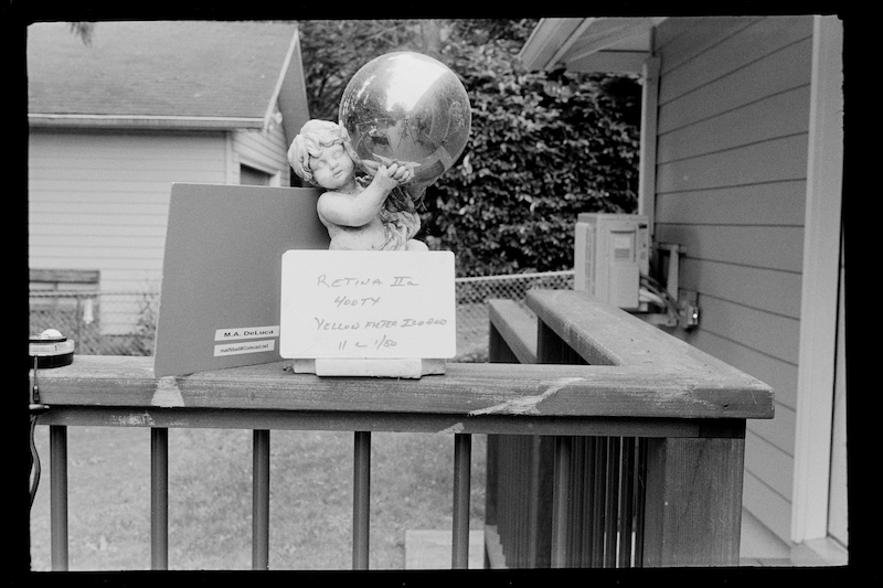

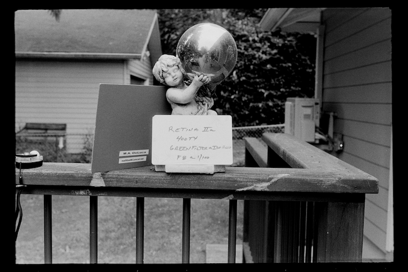

Thanks to all for the advice! I ran a short roll of Tri-X through the Retina IIa a few days ago starting with no filter, moving to a light yellow, then a green and finally a red. I adjusted the ISO to compensate for filter factor. It was developed in HC-110 using the dilutions and times for Tri-X rated at 400 as listed in Covingtons and the MSD charts. I used Dilution E (1:47) for six and a half minutes, fixed with Ilford Rapid fix. Other than the fact my focus was off on most of the roll, due to a combination of tiny viewfinder, bad vision, an achy leg that made it hard to squat down long enough to find the patch and just enough sunlight filtering through the trees to cause glare, the results were spot on. After scanning the roll with the Sony, I made almost no adjustments in post processing except for inverting the image. Since I know the crowd will demand images, here they are in all their fuzzy glory:

madNbad, interesting set of pics with different filters. What's the colour of the card leaning against the cherub and the colour of the wood on the side of the house by the door?
The lesson for me would be that none of the filters really help to differentiate the colours in this scene. The colours of the scene as rendered by the film without filters does this In the event that the highest shutter speed was necessary then all the filters do in this scene is to affect shutter speed
Unless filters help differentiate colours in b&w, are needed for an artistic effect or to reduce shutter speed then they add nothing to some scenes

This was more for my own verification to adjust for filter factor but develop at box speed. There has been the argument for always using a yellow filter with B&W film but with the modern films being so well balanced across the light spectrum, that may not be the case. I’ll keep a set in my bag and when the right lighting calls for enhancements, then I’ll get one out.
Thanks Any idea about the answers to my questions on colour of the card and wooden side of the door?
pentaxuser
The card is almost spot on with no filter. If you look, you can see the Sekonic 398 sitting next to the setup. The incident metering was on the cherub and allowed the door to fall into shadow. I’m about ready to head to the Evergreen Aviation Museum, home of the Spruce Goose, for a photo outing. I’ll just be using my M4, a 28, 35, 50, UV filters and the Reveni reflective meter. It’s an overcast day so the light may be a little flat.

But what color is the card, per Pentaxuser's question? If it is neutral gray, then using the card in adjusting all versions (making the card the same in each image - in scanning, PShop, however) can indicate the real effect of the filters. Or, you might say theoretically, if the filter factors were correct, the neutral object will be the same negative density in all images - a good test of the filter factors. Especially since different films can respond to color differently.
Also, (I hear you about kneeling down) you can always take a careful measurement between the lens and the object with a tape measure, then set the focus ring accordingly - I used a Retina II in high school, I know what you mean about the viewfinder.

If you are going to do more comparison testing please consider:
  • Including the sky with clouds
  • Multicolored subjects such as collections of flowers of red, orange, yellow, blue and green foliage
Then you will see the filter effects better.

Thanks for your second reply,madNbad. Useful info but it is the kind that answers my questions. I am assuming that the house wall colour and card against the cherub are familiar and known to you but if this was a scene you just came across and haven't seen again so you cannot recall those colours then that's OK as well but just let me know
Thanks
pentaxuser
The card is a standard Kodak gray card, the house is almost the same shade as the card with white trim, the light is filtered through the grove of a dozen hundred foot tall Douglas Firs that are the property line between my yard and my neighbor to the south. I may put the effort in to matching the gray on the card with the gray on the negative someday. We have had a fairly wet spring, so cloud cover and diffused light has been the norm. Just returned from the aviation museum and the gray sky gave way to blue with puffy clouds, I'm hoping for some good results.
