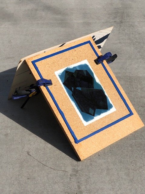

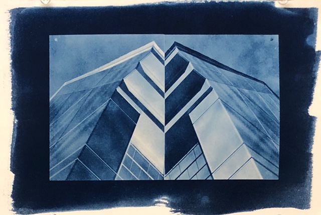

I spent all last spring doing cyanotypes and van dykes in an advanced photo class I was taking. I was shooting in 35mm and then enlarging that onto litho film that I developed in Dektol. I’d then cut the litho film images up and reassemble the pieces and contact print them on sensitized watercolor paper, some cyanotypes and some van dykes and some in a 2-step process that combined the two. Great fun.

(Sorry for the delay in getting back to you. I just started school again and have been swamped. I’m finishing up a Bachelor of Fine Arts degree. Plus the good weather here isn’t going to last and I have this new motorcycle to ride.)
It was an Arista Litho/Ortho I had from some years ago. I used Dektol 1:2. Here’s a couple photos.
