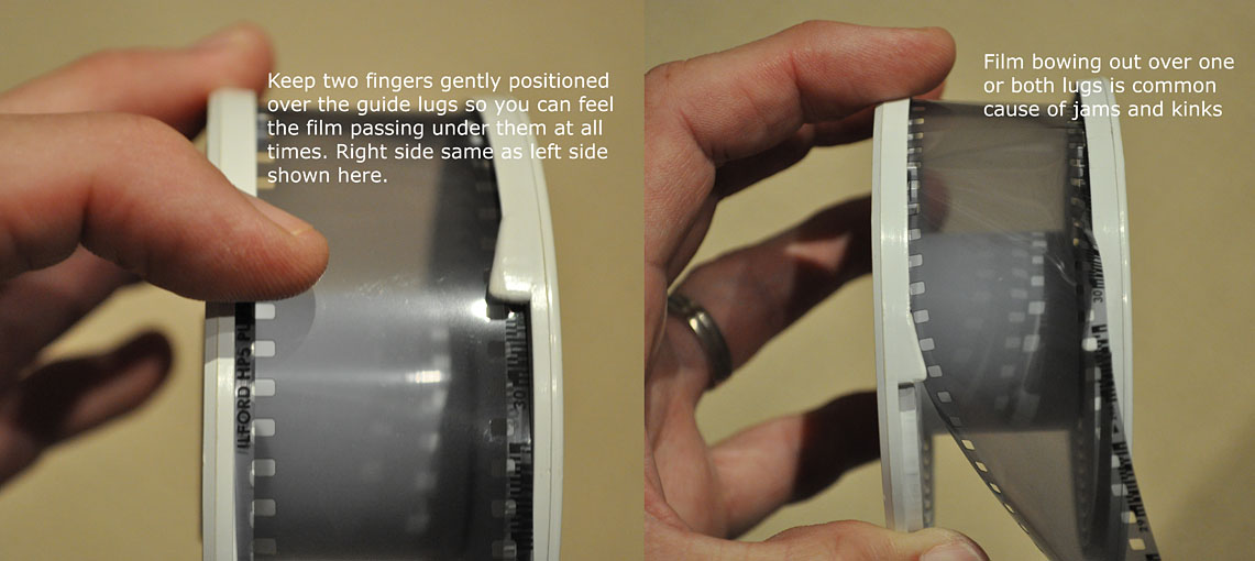

I occasionally had problems with these plastic reels until I started practicing the technique shown in the attached image. Also gently pulling out the sides of the reels as you twist has also helped if the advance of the film starts to stiffen a little. I posted an example a few years ago of how I load 35mm film with the canister between pursed lips. Causes a few laughs but is failsafe in my experience!
