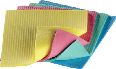

Can anyone recommend a good film wipe to dry negatives with? For a very long time I used viva paper towels that I stockpiled - but my supply ran out and the new ones scratch. I bought some pac-pad (sp?) from freestyle but they are not absorbent enough to dry the film. Any suggestions appreciated.

Viscose sponge clothes
I have wiped down miles of movie and photo film with such, not one scratch.
