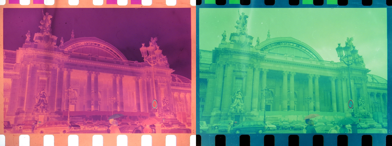

Hi everyone. I'm new to this amazing site.
After 20 years in a box, I re-discovered all my old film negatives. Most of them are color, some are B&W. I've never been a professional photographer, so back then I developed everywhere from Walmart to Kodak labs. Now I want to have all those photos (2000+) in digital files. I live in Mexico and the cheapest cost to scan PER PHOTO is around 1 USD. I've been trying different methods for the last month and the most effective seems to be to use a DSLR camera to shoot directly at the film negative while I backlit the negative. Well, turns out all the photographs have a green tone. Is it the film being damaged from 20 years in the box? Is it a mistake in my camera? I'm attaching the 2 pics for reference.
Thanks for you attention on this matter!
Ricardo

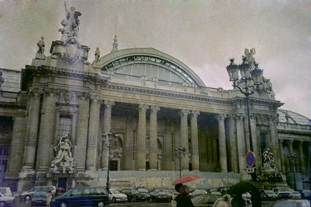

I'd be inclined to agree with John in that it's a problem of the light source you're photographing your negatives by, plus also not having software specifically designed to deal well with the orange mask. It's a shame you're so far away; I'd be happy to loan you a scanner that, while a long way from professional, would at least give you something to look at :smile:
You definitely have a nice memory encapsulated beneath all of that green goo...
Far from the best colour correction, but it was a terribly small file to play with! If all else fails, you can always keep doing as you have been and then convert them to black and white :smile:
I agree with DWThomas. The film is no damage. There is not a mistake in your camera and finally, this is not the best site for those questions.
However to help you with this a little bit, whatever the light you use in the film/file process, you must do a Colour correction (after/before) with the Colour negatives to get rid of the orange mask and achieve the right colour balance.
Buena suerte Ricardo!

I'm aware of the mottle, which is caused by a damaged gel I placed (only this time) in front of the light bulb I used to backlit the film. That being said, some of my films are physically damaged, but I'm not worried about that. It is what it is after 20+ years in a box. The green layer is what I'm worried about, but thanks for putting pressure on pointing us to what you thought the actual problem was.
Thanks for putting such effort on this! I'm putting the pieces together with all your help.
