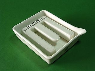

Everyone needs one of these:
(see Photo Memorabilia)
