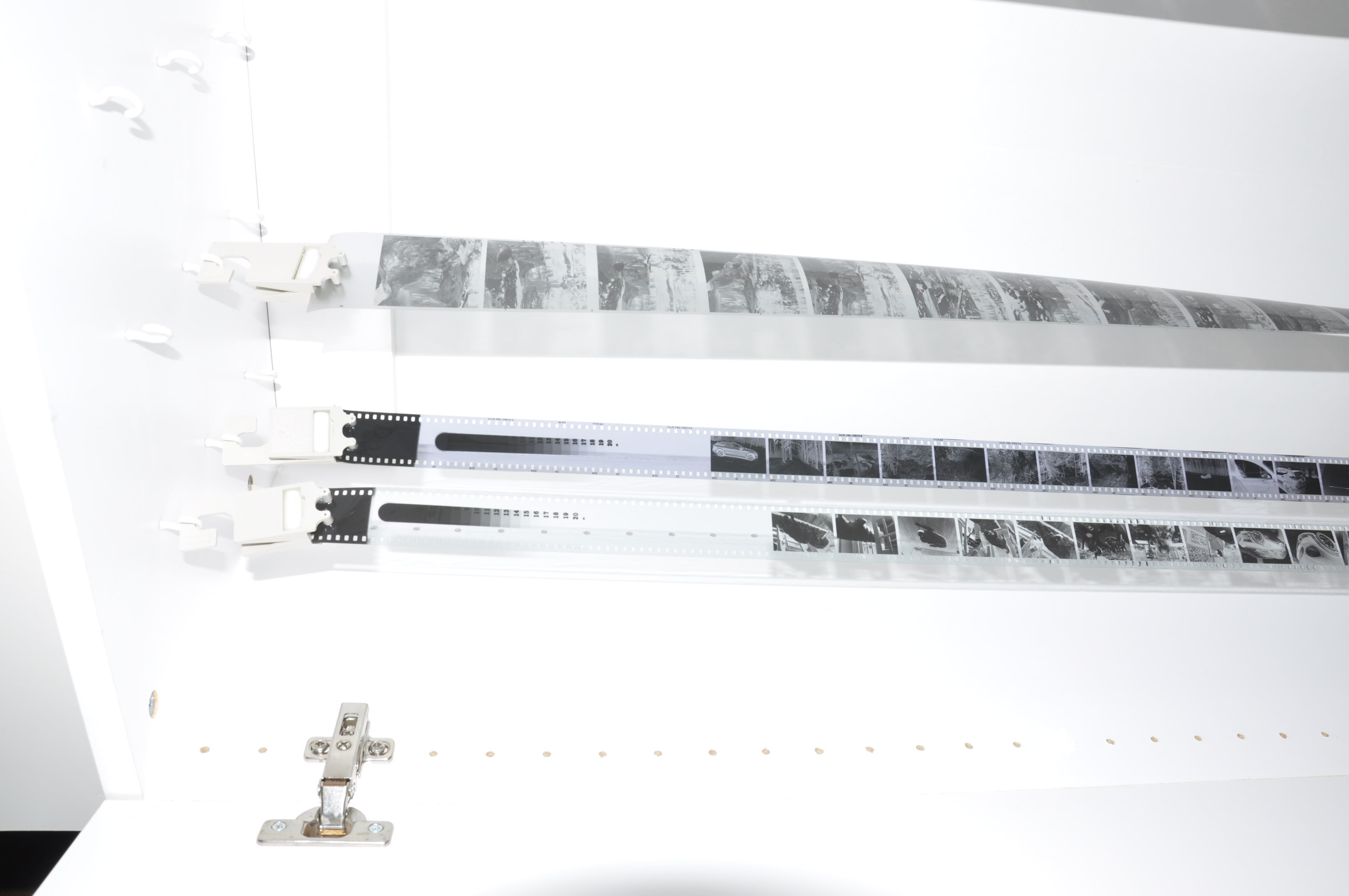

I just got some Svema thin based 42L film for testing.
Firtst off, 72 exposures of the film does indeed fit in a 35mm cassette. In fact I rolled 80 frames total into this cassette.

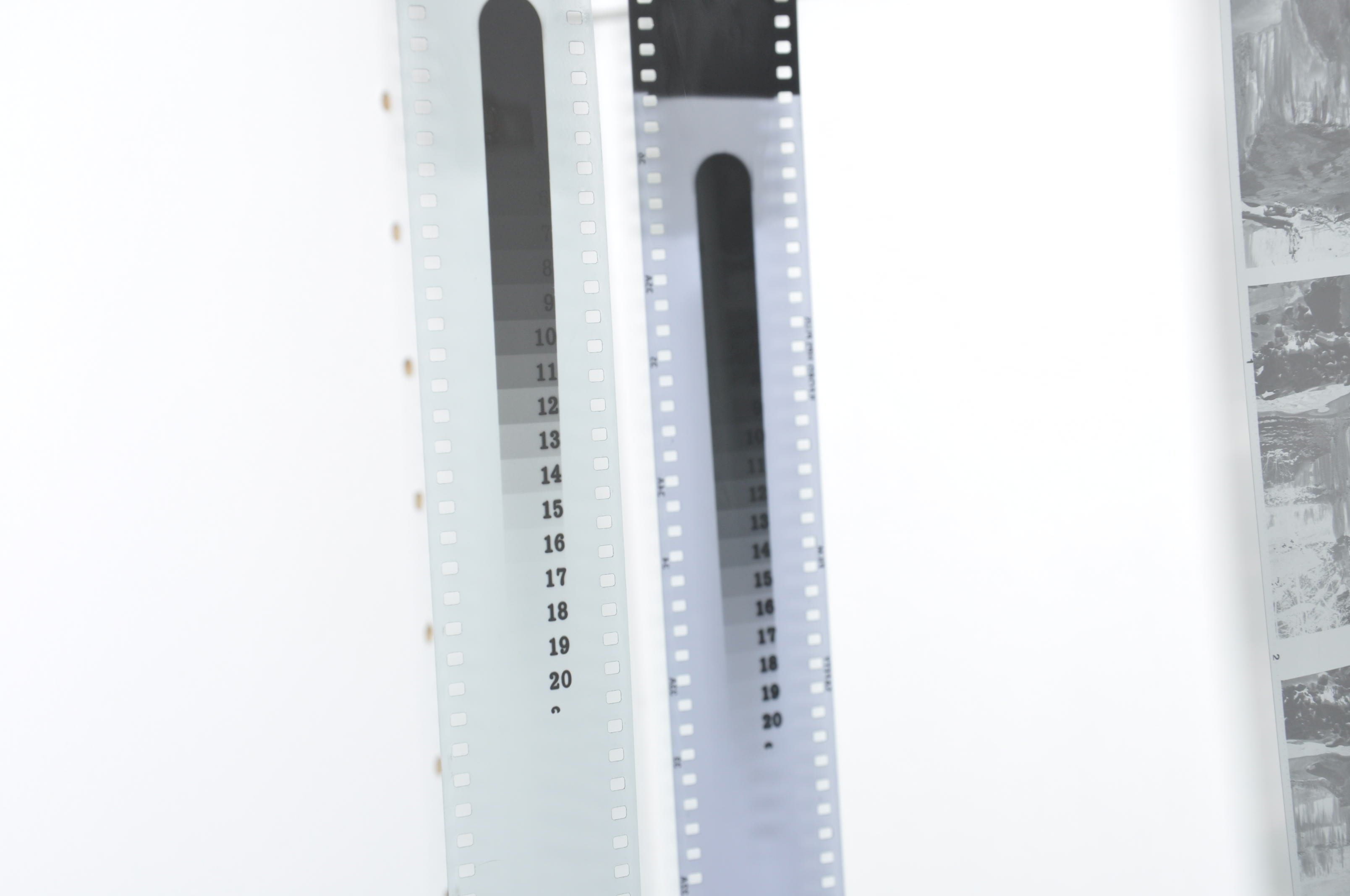

The Svema 42L was compared to Ilford HP5 35mm film.
Both films were exposed on the same white-light senstometer one right after the other. Then immediately processed together in the same tank.

First impression is that Svema 42L is medium speed and quite contrasty.
Just looking at this it appears the Svema (left side) is about 3 steps (1.5 stops) slower than HP5. I'm guessing, after plotting, the speed will be about 125 if HP5 is called 400.

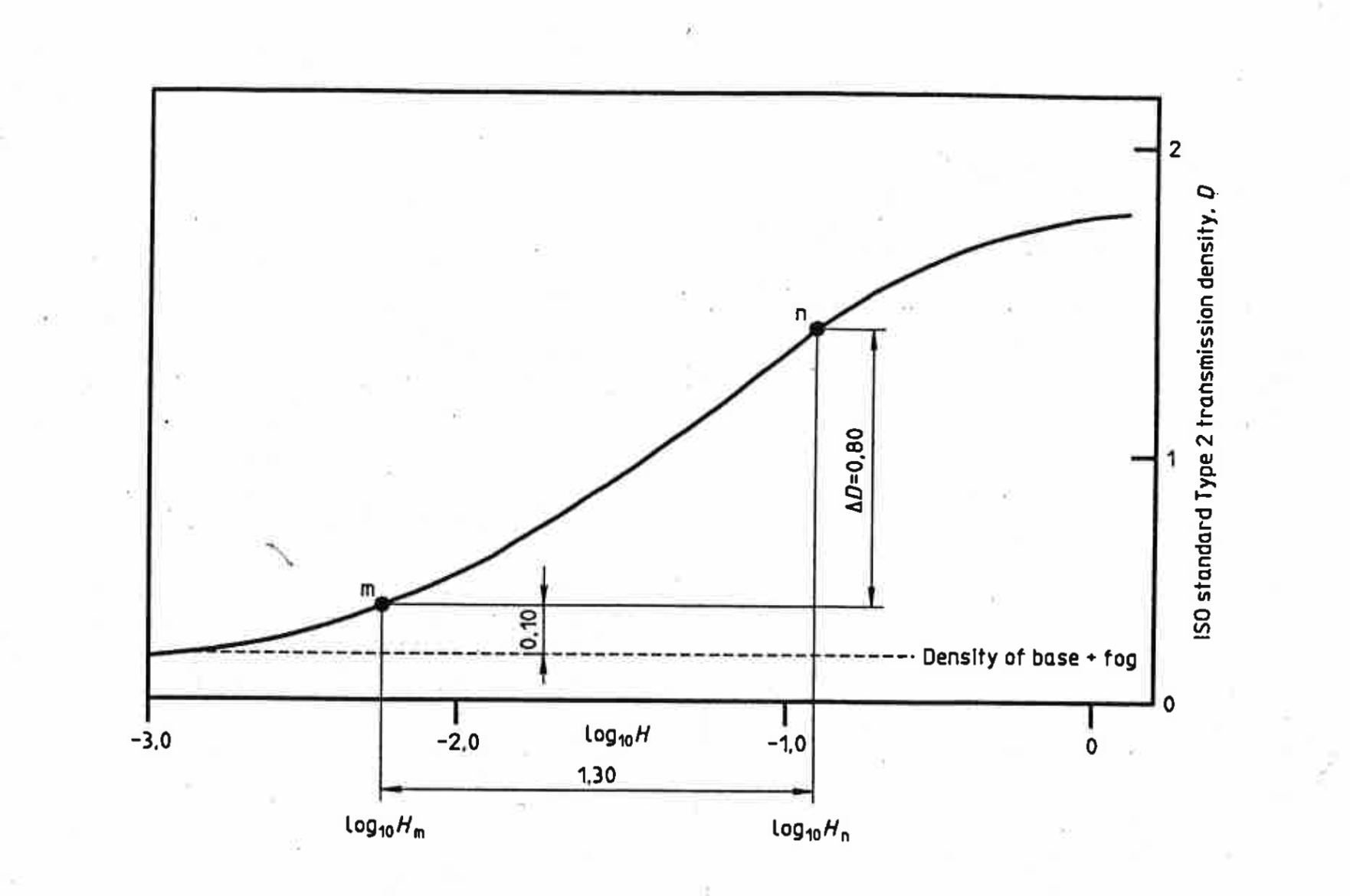

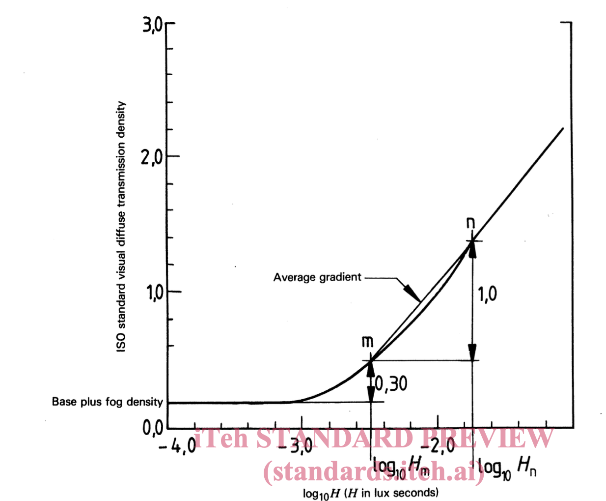

The speed rating of the film (1000 or so) is based on ISO ISO 7829:1986 (lower diagram).
Similar to ISO 6:1993 and ASA the most people know, the speed rating for aerial films is based on a speed point of 0.3 log d with a slope/gamma/contrast of 1.0 (or even higher).
So, testing the film with the ISO 6:1993/ASA (top diagram) criteria is a little challenging as the gamma needs to come down to 0.8 from over 1.
