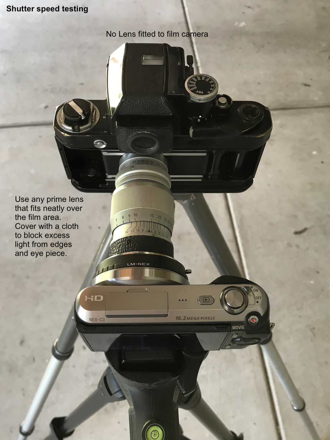

I have tried using the iphone app method but found it confusing to decipher the readout. So I thought what about just using a digital camera through the film camera shutter and comparing the resulting exposures. I also found that this will show up any open or close curtain drag.
My method is to use a Sony Nex with an adapted small prime lens. In the photo below I have used a 90mm Leitz. This I mounted on a tripod and the lens is pushed against the film camera with the back removed mounted on a second tripod (or you could put this on a table). The film camera has no lens mounted. Before each shot a cloth is draped over the intersection of the two to block out excess light around the front of the lens and through the film camera eye piece.
1st Photo
Set the Digital camera at - No Lens, ISO to suit, Aperture priority to get the speed you want to test (say 125th), 10 second delay. Put film camera on B press shutter to hold shutter open and take a digital photo through the film camera at whatever you have set it up to focus on.
2nd Photo
Set the Digital camera at - Manual and dial it to say 2 seconds, 10 second delay(for stability). Adjust film camera to the same speed that the Digital camera registered for the previous photo (was 125th). Press the shutter on the digital camera and when it fires then fire the film camera. You have now used the film cameras shutter to take the photo onto the digital sensor.
3rd Photo
Do exactly the same as the 2nd Photo but this time adjust the film camera to one stop faster so in this instance 1/250th. Take the 3rd photo.
Now compare photos 2 and 3 with the 1st photo.
I generally find that my good film cameras have good exposure comparison between photo 1 & 3. Photo 2 is generally brighter which would mean that the shutter on the film camera is a bit slow but I think the digital sensor staying open for 2 seconds gets a bit more light - just a theory. If photo 3 is still brighter than photo 1 then take another at 2 stops more which would be 1/500th. If this looks more like photo 1 then it is likely that you film camera shutter could be slow and your shots will over expose on film.
What do you think of the viability of this method?
(Hope this is okay in this forum as I figured it is about testing/repairing analogue cameras - the digital aspect is just another tool to do this - actually you could use a tried and true film camera as the rear testing camera so then the negatives would give a very accurate result with no wondering if the sensor does this or that at 2 seconds or the software still manipulates the image etc.)

I do something similar with my roller blind shutters and it works well. The only difference is it's simpler in my case as the shutters fit the front of a lens, I ve done the same with Luc, Gitzo, Le Mignon, etc, front mounting leaf shutters.
It's only a relative speed test and relies on the supposition that the Digital cameras speeds are accurate.
Ian
1st Photo
2nd Photo
3rd Photo
