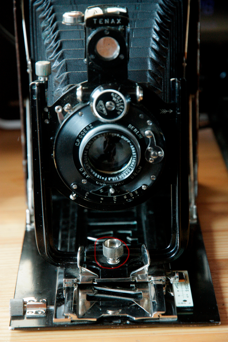

May I know the purpose of this screw?
baachitraka
baachitraka
Apr 6, 2011
3,568
Bremen, Germany.
When unlocked, it makes it possible to shift your lens/lensboard horizontally.
Btw, very nice camera!
I did not try to shift. Raise and fall is not bad.
Yes, need a bit of gluing and painting.
Need to find film sheaths, nevertheless.
