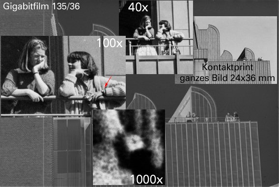

I have recently become a bit obsessed with turning out the sharpest most detailed images and I would like to get peoples views about film use, specifically B&W.
There's detail captured on film, and there's detail in the final print. Which are you trying to maximize? They aren't necessarily the same thing. The print in particular depends on the enlargement level, and the bottom line is, if you want big prints, shoot big film.
If it's just an exercise to see how much information you can pack onto your film, you might try something like Tech Pan. I've never used it and hear it's a PITA, but if it's absolute resolution you are after, that's a possible path.
