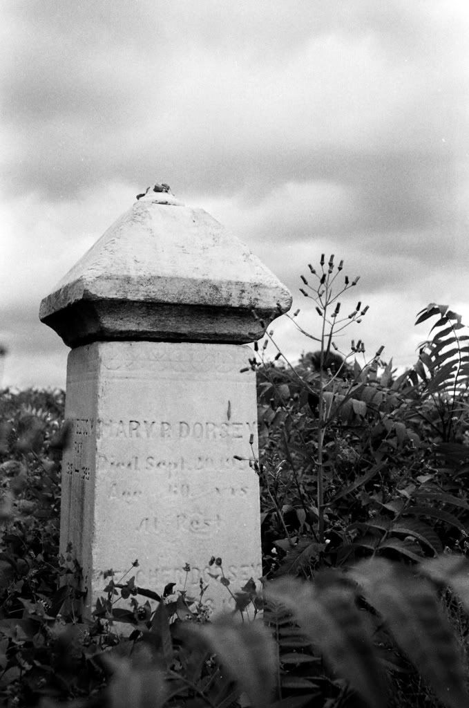

Shooting 400 in bright daylight with my old cameras limits me to my fastest shutter speeds and smallest apertures; a good thing for zone focusing and shooting quickly, but limited choices for DOF. When shooting BW 400 I try and carry around a 2 stop yellow filter when I want to open it up a bit, like here: Bessamatic w/ Color-Skopar, Tri-X
